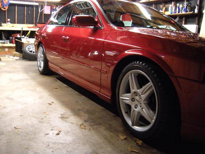

ok so I know a few people on here have 285 on the backs. What are your offests? I'm looking to run a 285 and a 10" wheel but I cant for the life me keep the offest numbers straight
well i do know that the 60mm offset on the 9.5 sits perfect. So the smaller the offset the farther it will stick out so in my head and ok math a 10 in wheel is a half in wider wich means the 10 in wheel will sick out roughly 12mm so 60 minus 12= 48 Does this make sense??
tough to tell from that pic. I want them to sit just inside.... I'm not opposed to rolling the fenders... but from the tire calculator i found online i would need 66mm offset to stay where yours sit
Correct, if you wanted the outside of the 10" wheel to sit exactly as the 9.5" wheels do with the +60mm offset you will need a +66mm offset on the 10" wheel.
Previous poster's math was a little off. 60mm + 12.5mm/2 = 66mm for your 10" wheel. The offset must be added in order to keep the outside of the wheel face at the same plane as the original. The addition of only 6mm and not 12 is necessary because relative to the center of the wheel the 10" is 6mm larger on each side than the 9.5mm wheel.
