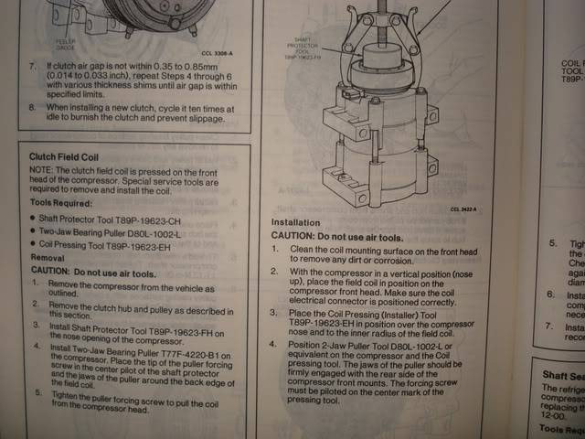

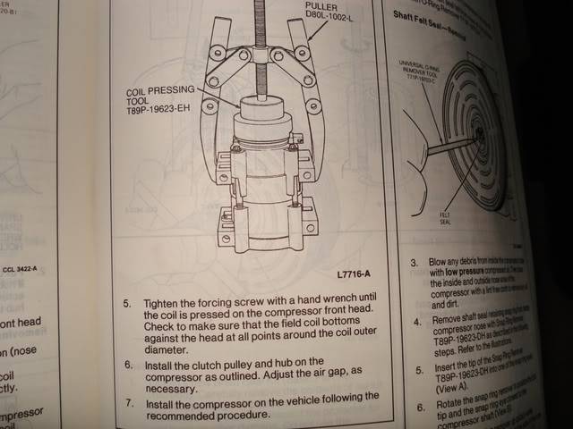

You should really test the field coil first, just in case the problem is elsewhere.
if the compressor is kicking on when he looped the pressure switch connector, his field coil is good. if the coil was bad the compressor would not kick on. the coil controls the clutches directly.
