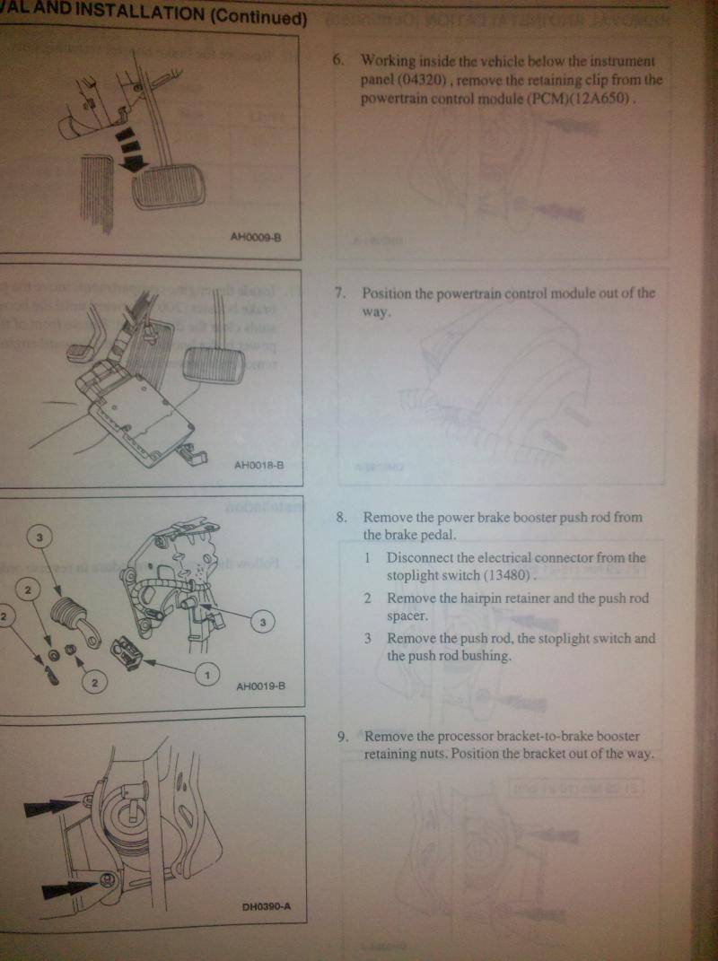

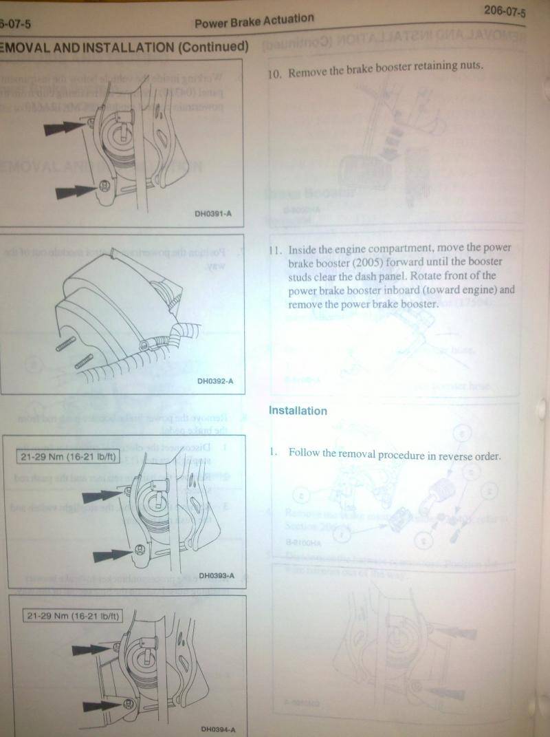

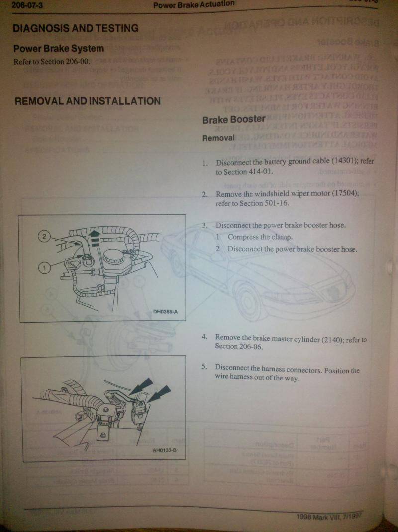

Ok I'll send Laser the pages of what you need to remove the VCs...he can post the pics

Here's the pics....

That's the brake booster. You haven't removed it, you've just disconnected the master cylinder from it.
Taking the actual booster off is a bit of a pain - time consuming, but would make access easier.
That hump is the booster. You've only removed the master cylinder. The booster is connected to the brake pedal. You're going to continue to have headaches until you remove it.

There are two nuts that secure the brake booster to the firewall. They can be accessed inside the car behind the brake pedal. All you have to do is loosen the nuts enough to pull the booster towards you, giving you enough room to remove the valve cover. You only need about six inches.

theres 4 bolts inside the car on the booster, gotta disconnect the pedal too, remove booster, if you still cant get it completely remove the ds motor mount bolt and jack that side of the eng up
Step 9 & 10 are the same step aren't they? If so I'm at step 11 and it's the brake booster isn't moving. Nuts are off, booster is not budging.
I'm gonna go with ripped-camel at this time...let someone else do it before you :q:q:q:q up a nice car
no 9 you are taking off the bracket that holds the processor
so you will be taking off two nuts per stud

if the booster (big black hump) wont move then not all 4 of the nuts are off, when they are off it will slide right out
