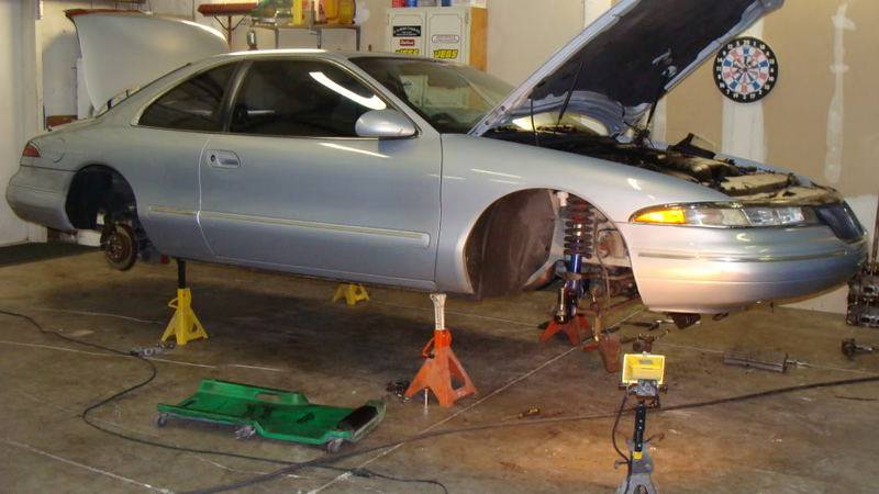

i will agree with doug 1000% i have been working on these particular lincolns the last 11 years and i have yet to invest in a lift, this is where i work on them, jack stands and a creeper, thats all i need. i would love a lift, but can manage fine without it.

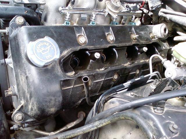

There are two nuts that secure the brake booster to the firewall. They can be accessed inside the car behind the brake pedal. All you have to do is loosen the nuts enough to pull the booster towards you, giving you enough room to remove the valve cover. You only need about six inches.
There are three bolts. That bracket that holds the computer is held on by two nuts and two nuts under that hold the booster in place and then there is the last nut on the opposite side of the armature.

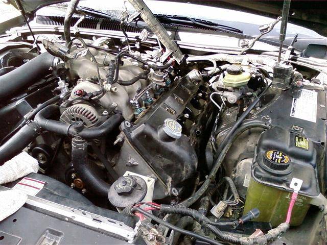

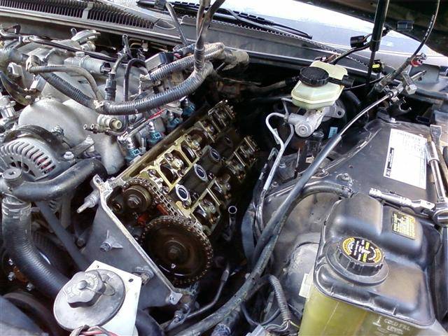

wow........one thing i learned when working on cars, not just the Mark, make room, a lot of room, take stuff off, u can always put it back..........anyway, found some pics of when i did my valve cover, lifting the engine just a bit is all i needed...............

I asked if he'd taken out the motor mount through bolt. I even got off my ass, went out to my garage, snapped a picture, and posted it so he'd be able to find it.
I suggested that he put plywood under the jack stands to keep them from sinking into the ground, because I've been there.

theres 4 bolts inside the car on the booster, gotta disconnect the pedal too, remove booster, if you still cant get it completely remove the ds motor mount bolt and jack that side of the eng up

Can you find the pieces of the cam towers?
Anyone know what type of aluminum they are made of?
Any chance they can be taken off the head welded back together cleaned up with a die grinder and re-installed?

Holly Bat Sh#t Robin!, First do not even try to run the motor without the cam girdle, the flex from the followers will snap the cam. Second, you might get lucky with a used girdle, but to do it properly you will need to remove the cam and I have serious doubts about that happening properly;) Get a new head and have someone help you. And next time deep breaths, listen to the people that are trying to help, and calm down.......
