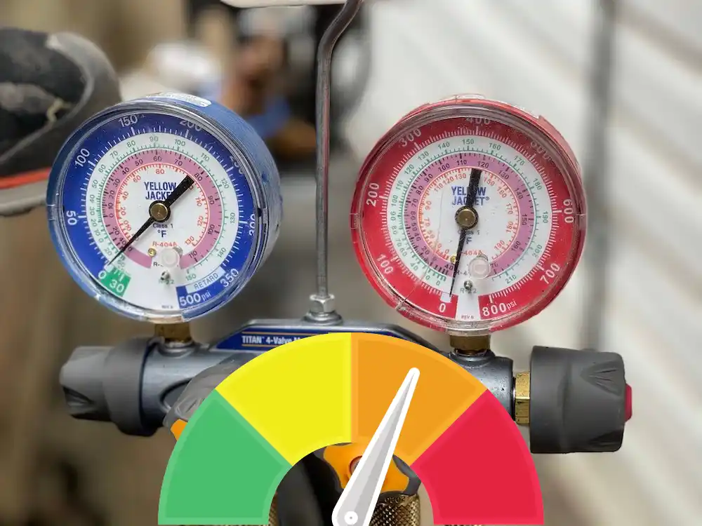

Blue GAUGE, (not "valve"), is low side pressure. Red GAUGE is high side pressure. BOTH have to be connected.
With gauges connected and engine running, (and A/C turned on), both gauge needles should be in the GREEN section of both gauge dials.
If either gauge needle, (or both), is in the yellow section of the dial... that is slightly overcharged, and some refrigerant will need to be removed/recovered. Just enough to get the needle back into the green.
If either gauge needle, (or both), is in the red section of the dial... that is overcharged and will definitely need some refrigerant removed.

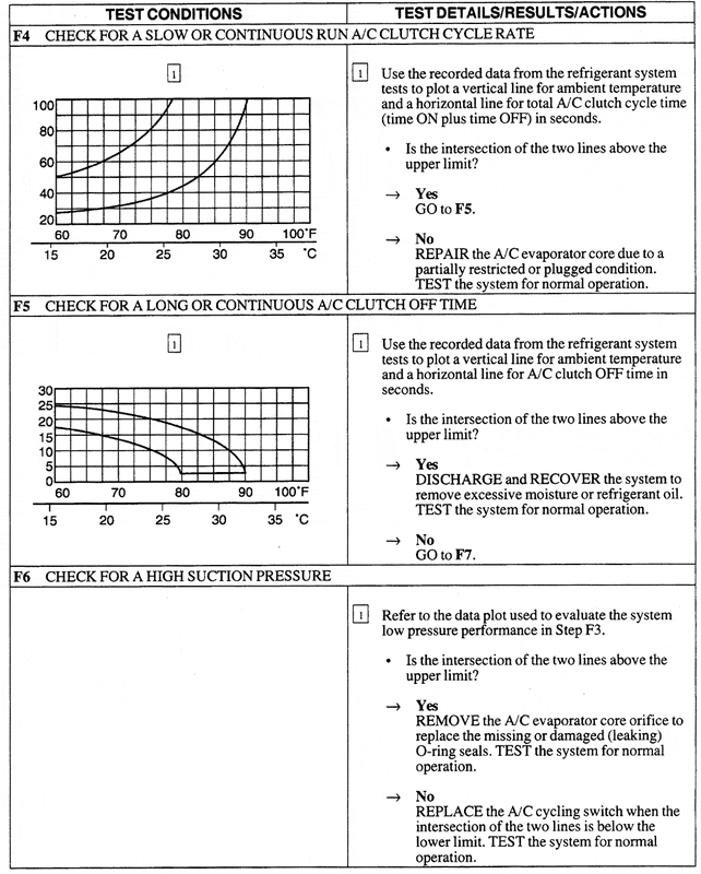

I'm not sure I'm the one to help you but I'll chime in. Several years ago I had some AC issues with 2 vehicles. While I thought I needed two new compressors in the end both cases I was wrong. Fixing your own AC can be very frustrating and unrewarding. I found a used dual r12 & 134a recovery/ vacuum and charging machine. It was missing all of the hoses as well as the vacuum pump and one of the recovery tanks. I didn't know about the vacuum pump when I bought it. Eventually I got the things I needed which was more expensive than I bargained for especially considering I didn't actually need two new AC compressors. I did my research and went about fixing my Conti and wifes Pacifica. I did get both working but not as cold as they are supposed to be. As far as I could tell the Conti had too much oil in the system even though I followed the instructions to the letter. The problem is unless you completely blow out and flush the system you don't know how much oil there is. Too much is better than too little but after a point it starts to affect efficiency. Now that you have probably overcharged your AC and with each can of refrigerant added more oil you also don't know how much you have in there. You can also damage your compressor if there is too much refrigerant and oil (hydrolock as I found out).
If you still want to attempt to fix it yourself I would recover some the refrigerant and then add some dye and check for leaks. The fittings on the high and low ports should be changed since they are prone to leaking. When you connect the hoses to the fittings do you get a lot of oil when it vents briefly? If so you probably have too much. I had this.

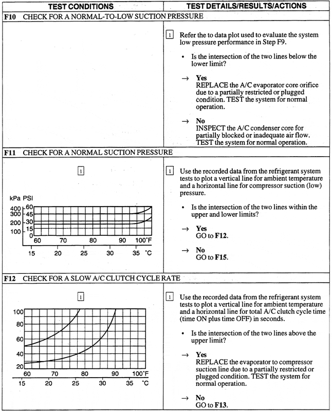

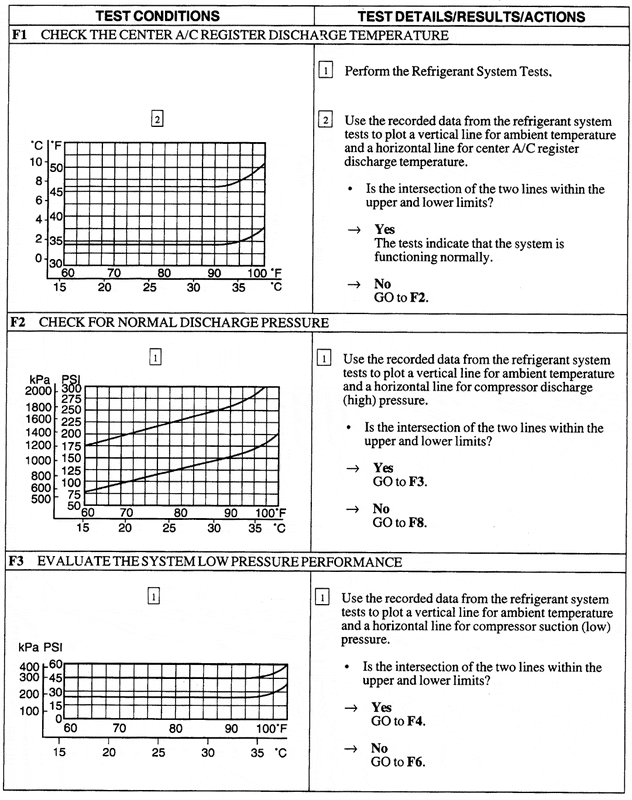

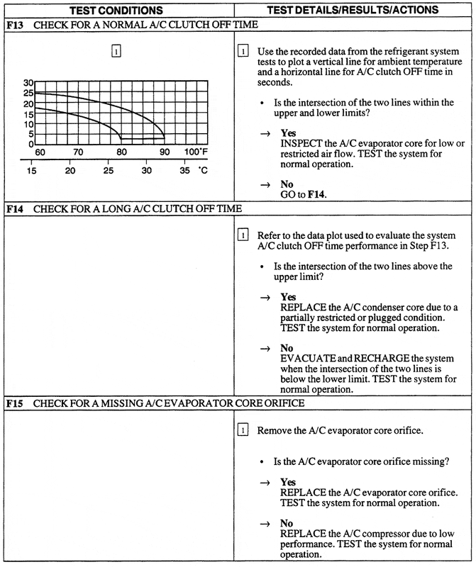

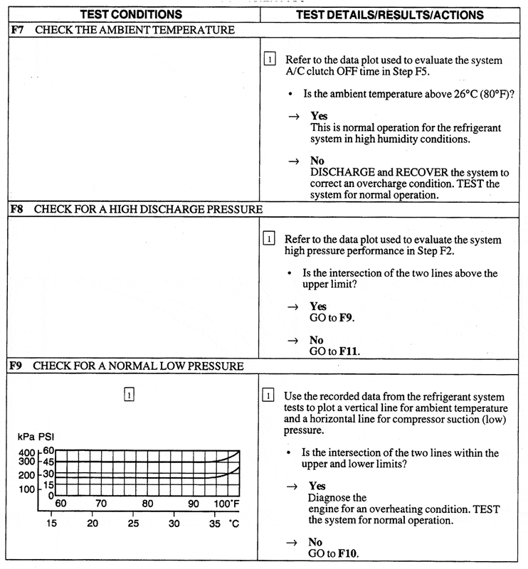

Here is a link for AC pressure readings that I had bookmarked from then.
According to the repair database I have access to the system holds 28 ozs of 134a and 7 ozs of pag oil. There wasn't any diagnostic reading charts for the LS but I did find these for the Conti I had. I'm not sure if they apply or not. They may be helpful to you.

...According to the repair database I have access to the system holds 28 ozs of 134a and 7 ozs of pag oil. ...
There's really no way to say how much refrigerant his AC system needs, because he has put a V6 compressor in a V8 system. The two compressors and systems have different capacities.
Also, I wouldn't recover refrigerant from a contaminated system. His first compressor seized, and he didn't replace the condenser or the dryer, and didn't flush the rest of it.
I understand he has a budget here, but he is now just wasting what he is spending on it because some things absolutely must be done if it is going to work.
