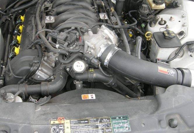

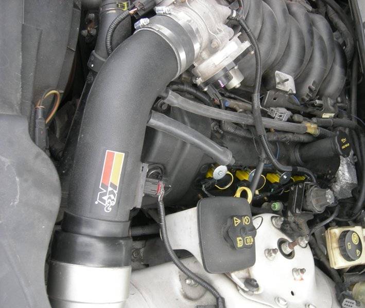

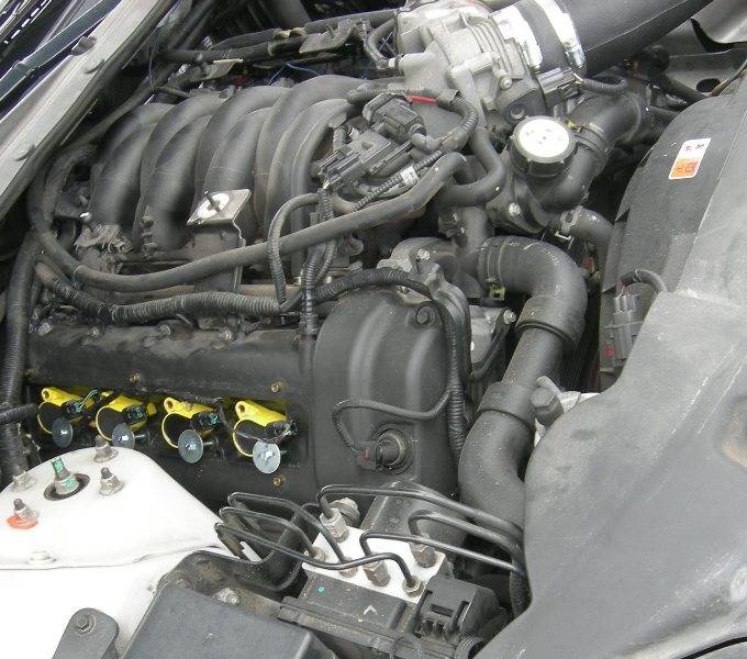

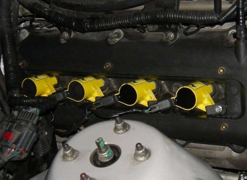

I have been running these 99-04 Mustang 4.6L 2V ACCEL COPS now for a few weeks and no problems what so ever. The car is more responsive over the stock coil and my gas mileage actually went up as well whcih is an added bonus. I figured it was worth a shot over factory COPS since these can be bought for around $200 for a set of 8 all over the internet.
Here are a few pics. I know my engine is dirty, now that it is warming up outside I can detail it for the summer ;)

Are those fender washers on the COPs?
I've always liked the Accel product coloring, they stand out nicely.
Do they output a higher spark voltage than stock COPs? Did you have to change your spark plug heat range with the new coils? Did you change your plugs at coil install time?
1. Yes those are fender washers and longer bolts holding the coils down into the spark plug holes. The Mustang COP doesnt match up to the stock LS holes so this is how they have to be held in place.
2. Yes these produce 15% more voltage over the stock coils.
3. No the plugs do not have to be changed.
4. I do have new plugs in the car but they are not required for these COPS.

Wait. This is an LS? I thought that the V8 throttle body was in the rear. Somehow, I had thought this was on your mustang. Sorry! I didn't realize that the V8 upper intake looked like that at all. Is there some way that you could fab something out of those fender washers in order to be able to use your coil covers again by eliminating the unneeded washer material?
The reason that I asked about the plug change was that it could throw off your SOP perception of increased power due to higher spark voltage, as well as fuel economy calculations, if you changed the plugs at the same time as changing the coils. I know that on my first V6, changing the plugs and one bad COP at 102K miles resulted in a 1+ MPG increase in gas mileage. What was your observed mpg increase with these coils and new plugs?
This is a 04 V8 LS, the engine is different than the 00-02 V8's. These are Mustang COPS on the LS motor.
Im sure something could be fabbed but I have always run with the coil covers off to let out the heat so they dont fail.
I changed my plugs 6 months ago so they are still considered new with the low mileage I put on per year. The coils alone are responsible for the increase as I had the old coils on the same plugs a few weeks back. I went up 1.5-2MPG in the city on these so far.

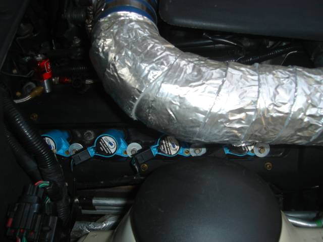

I was just about to ask is there only one way that these will fit into the valve cover? That looks much better than the washers. What are the things you used to hold them down with?
Got a part number for those cops?
COP part number are ACCEL 140032
I used a U clip to hold these in place. They hold the COPS perfectly.
Yes The Harness Plugs Are the Same Through All The Years....Here Is A Pic Of My 2000....So Yes It Can Be Done With Any Year Model
