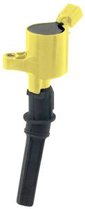

Yes! They come with a boot for the 2V Mustang which has a bend in it. I didnt check to see if they would work because I had 8 new boots sitting around for the LS anyway. Here is a pic of what you get.

For those who asked about the Mustang boot on these coils fitting into the LS motor, the answer is it will.
I put them in yesterday and they work just fine, actually I recommend them because the wider part at the top of the boot completely seals the spark plug well and will not let any rain or dirt down into the well.
The Mustang boots make a "V" type shape. You will need to put the boot in with the low part of the V toward the bottom of the well and then shove the rest of the boot into the well to make it have a tight seal.
