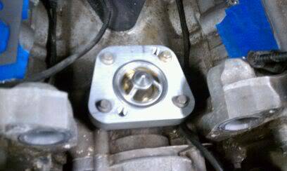

It would be badass if you could do an aluminum degas bottle.
I think the billet cap from the mustang bottles will work already.

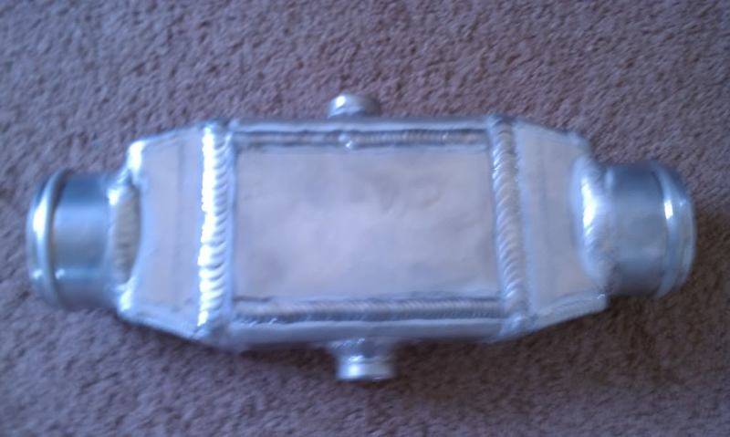

if you are using aluminum - i believe TIG is the proper welding choice - no? MIG is still to hot for most aluminum.
Your correct.. With the thickness of aluminum, I should be fine.. I think the MIG I'm using also has the pulse function too..
Maybe when mine finally dies.. :rolleyes:

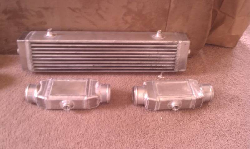

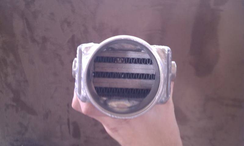

Not to come off like a jerk but your air to water units your blowing all your air thru (3) 1/4 inch wide slits 4 inches long!! Holy bottleneck.
Not really worried about pressure drop.. As stated before, the m90 can put out a lot more than I can use.. plus, using one for each side.. they're little though..13x4x2.. and the inlet is 2.5..
