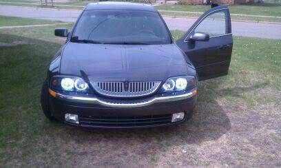

Also, got to see my angel eyes and HIDs on the car.. Except I'm having problems with them as they like to turn on and off all the time..

ive seen a few Ls's that has needed a relay, for the HID kits to function properly, it really depends on the kit, ive also seen a couple that worked fine off of the factory wiring.
A pic of the Linc out and the angels, hids, and tinted turns..
