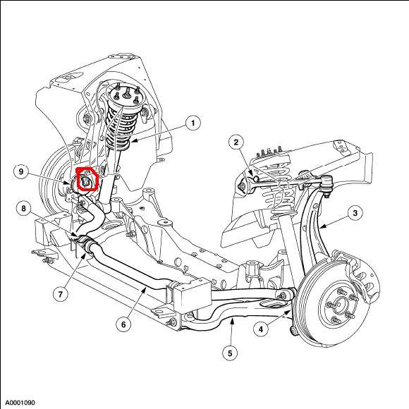

Is this the wheel speed sensor by chance? It's the only thing that looks like it could be it.

Quik, do you happen to know if the front passenger side wheel sensor is the bolt or snap on variety?
They always ask if it's a clip-on or bolt-on - I don't know if there were two manufacturers or certain build dates received different ones... so you have to look - it's quick and easy - the bolt-on has a single bolt holding the sensor into the spindle housing.
So we got it to quit acting up, the things we noticed were two wheel speed sensors were not on all the way and one had a little moisture in the hub. Blew the moisture out and secured the wheel speed sensors and all is well in the life of Kulow's LS.
