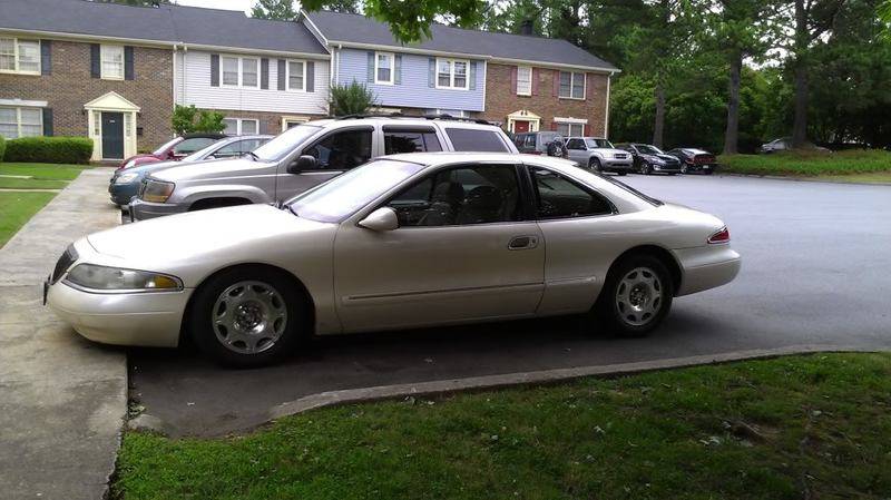

it will sit all night and not leak out. ill come out in the morning and it looks like this.
no sag. and to me, it looks like the whole car is sitting high.

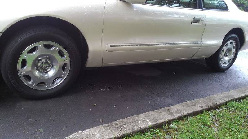

looks like this when it sags,

it looks like your mark was in 4X4 mode sittin all up high like that, that would show that system is not venting properly, and the pic with the front end on the ground looks exactly like my mark did when i had a leaking front bag.
new air bags, and sensor lower it.
maybe a stuck vent? but definitely leaky bags.
^ what he said.
Try adjusting the rear sensor bracket all the way down as far as it will go. And adjust the front sensor lower mount up as far as it will go. If that doesn't work, jack the front end up with the air ride switch left ON and let the front solenoids vent. Then let the front end down again and see if it settles at a more reasonable height. It may or may not work. But it's worth a shot. The 4x4 mode just looks so wrong:D
