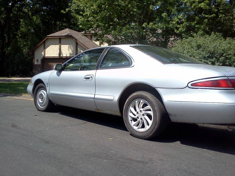

i think it's mad because of the wheels you have on the car. :d
j/k. Dude, sounds like your ride height sensors may be causing the issue but then again, don't listen to me. I went through 3 years of dealing with air ride issues on my marks & finally converted to springs on both my cars.
do you know where i can buy a rear height sensor # f7ly-5359-ba ?
Any help would be appreciated.
car has been converted. used everything from a v6 thunderbird.rides MUCHH better. but i have warranty/ exchange on all the parts. ive heard that the v8/SC thunderbirds sit lower, true?
Nope it will sit higher if the springs are stock.
http://www.lincolnvscadillac.com/showthread.php?t=83618
A V-6 Thunderbird? Mark VIII's are a lot heavier than V-6 Thunderchickens. Have you noticed any floatiness or bottoming over bumps/dips? I just don't think the V-6 'Bird springs/shocks are going to be stiff enough to handle the extra weight you've subjected them to. But I could be wrong...
