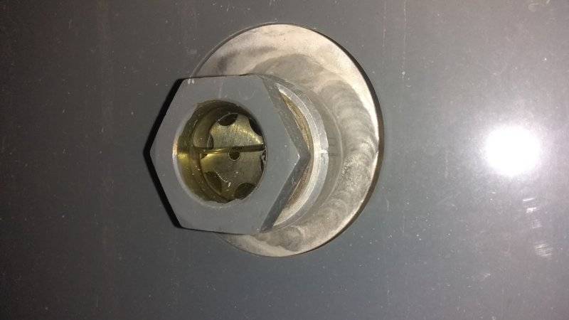

Well hmmm. In perusing the internet for sight glasses... I stumbled across this.
Coolant Sight Glass
Joe... a bit off topic for this thread... but would something like this be beneficial to bleeding the LS cooling system... and where would it be best installed? Possibly the upper TB heater hose? That would be the highest point on the engine... correct?

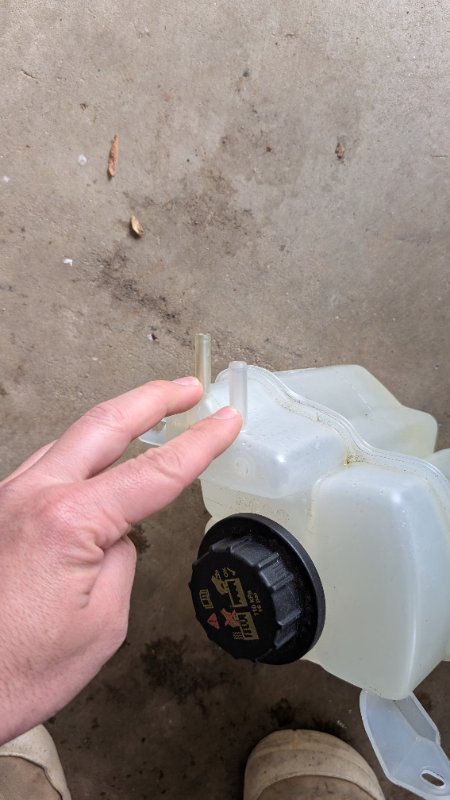

Chiming in -- just installed the ebay bottle and noticed that, unlike the Dorman, both tubing stubs at the top (by the fill cap) are open.

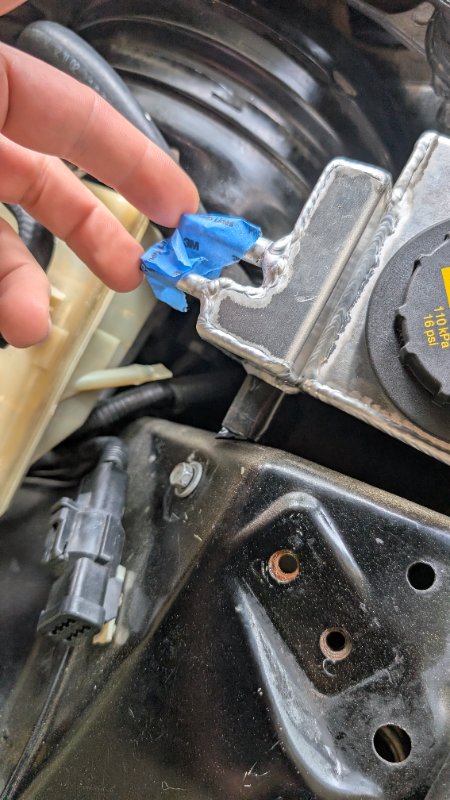

On the Dorman, the narrow (5/16"-ish) stub is metal-sleeved, and takes coolant from the thermostat housing. The other (3/8"-ish) is un-sleeved, and doesn't actually pass through to the interior of the bottle. It's just meant to serve as a post to hold the air bleeder tube in place.
So... running the aluminum tank, I need to put a cap on one of the stubs or else the system will never pressurize. I'm choosing to cap the larger 3/8" stub with an HPS brand coolant cap ordered off Amazon, to the tune of $16.
I could instead go with Dorman's coolant caps, but I'm trying to *fix* the car.. And a cursory googling revealed that Dorman's fail within months due to being made of a material incompatible with coolant. To heck with all that.
So I'll be capping it, and THEN bleeding the cooling system..
