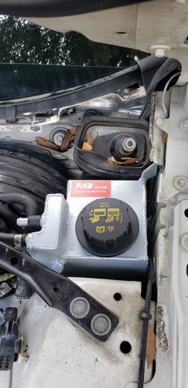

I took the plunge and bought the Ebay bottle and I had to bend alittle of the flair where the 10mm bolt goes at the top of the factory bottle to fit and had to self tap the other 10mm it was tight between the brake booster but it's in and I have had 0 issues.
No issues will take a picture when I get home
Just curious why you want an aluminium cap? The plastic MotorCraft Caps should work fine...FWIW I think I'd prefer a plastic cap over a metal one...Thanks for stepping up to the plate and taking a swing ...much appreciated From the pictures it looks like it's right at home on the LS and should have been on the LS from the start
Well I check it on the regular in the mornings and I dont have the means to make the glass modifications. Also if my lincoln developes a leak the car will let me know. As I'm sure any ls owners already know that has had any coolant leaks.
This was just a suggestion to anyone that checks there fluids constantly and cant fab one themselves. Same price as our crappy dorman bottles.

This wasnt supposed to be a point out the obvious (that it doesnt have a glass piece) I wish it did but it doesnt. It was supposed to be to show there is options if you cant afford the motorcraft bottle and or have constant dorman failures. Just trying to give the forum a few month tested option and my findings on this product

Only wanting to find a metal cap for fear of longevity as the aluminum bottle is warmer.
It's the same temperature, roughly the same temp as the coolant. Aluminum just feels hotter to us because it transfers the heat much faster. Same reason room temp aluminum feels ice cold
