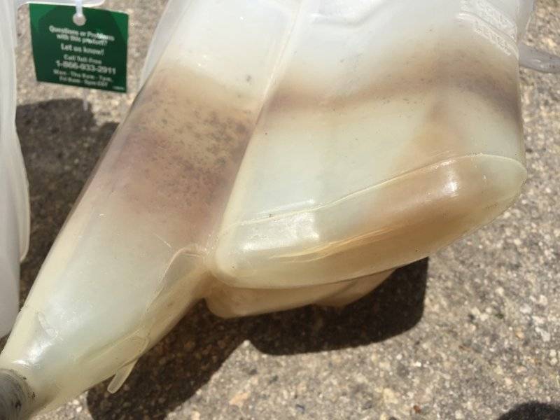

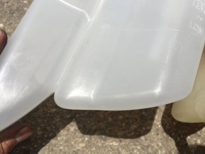

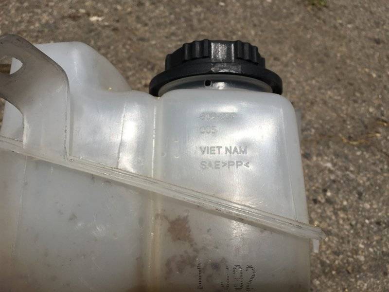

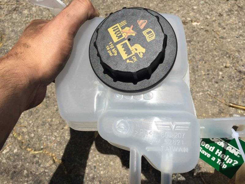

Just an FYI. Dorman revised their degas bottle. It is now made in Taiwan instead of Vietnam. I can tell the mold used is different and the bottle is much better made now. I have been waiting to make a thread on it, but thought I’d share now since this topic is active here.
I will make a thread one of these days with more details. The Vietnam version used to last about 3k miles or 6 months max. The new Taiwan version is doing great so far at 8-9k miles. The container color has not changed much. The old one would yellow rather fast before.

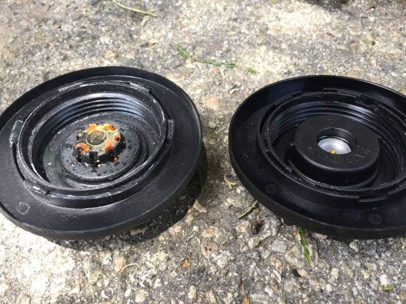

I wonder if the cap changed too or its the same crap one that gives a lot of people trouble.
Cap seems different as well. I don’t remember if the threads changed as well. Left is the Vietnam cap, right is the new cap that comes with the Taiwan tank.
Visually you can see a difference...what matters is the pressure specs on this different cap...ty for the pics and the start of a informative thread my LS brother
YES. Definitely an overall difference on everything. The reason I didn’t make a thread when I first got it was because I wanted to make sure the new revision is actually an improvement worth purchasing. I didn’t want to give people hope only to find out it fails just as often.

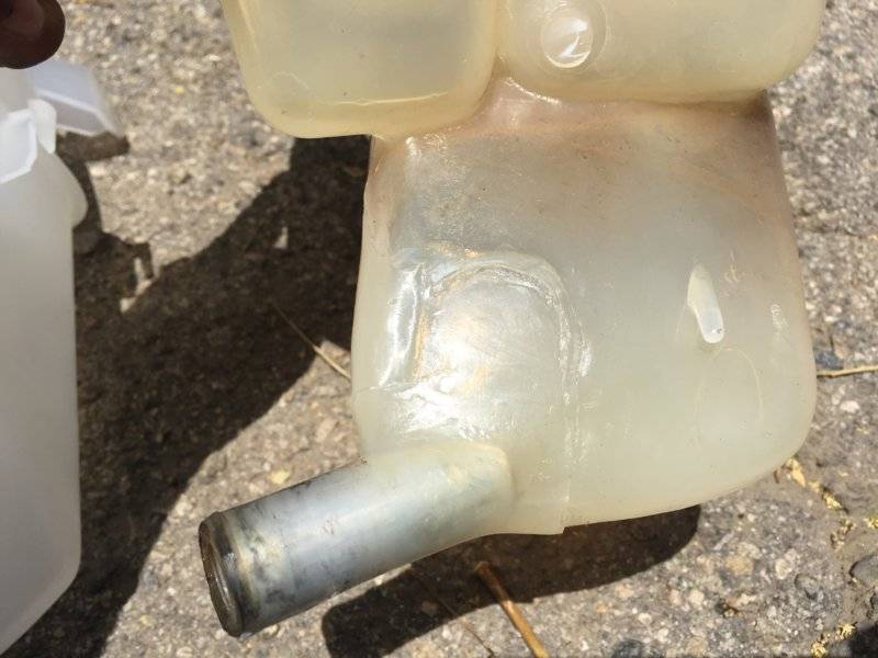

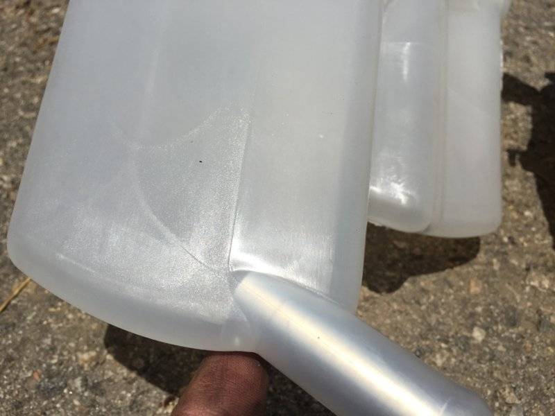

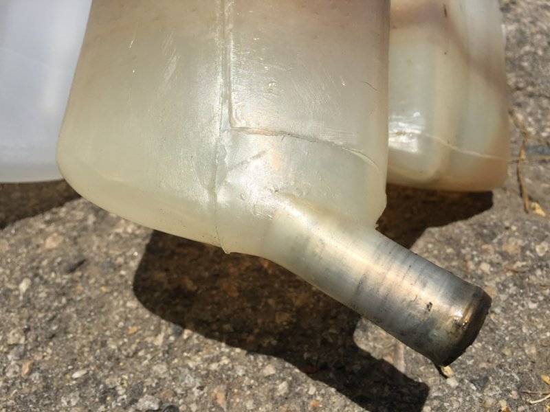

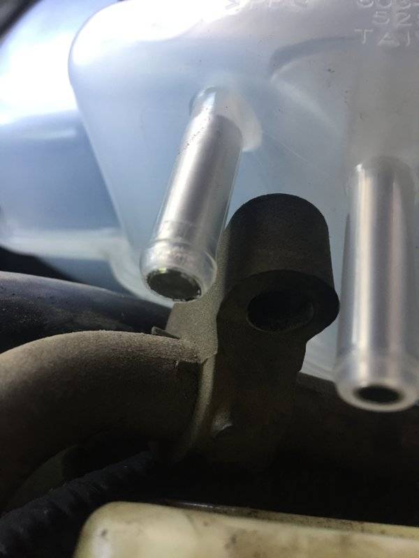

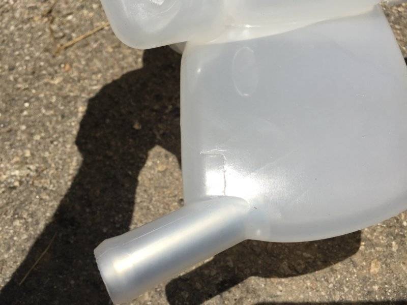

There is one thing we should all be aware of though. The first Taiwan bottle had a defect. The tube where the heater air bleed hose attaches to the bottle was hollow. So that tube was just plugged by a thin wall. It burst after taking it for a test drive. The second bottle, however, had a metal rod as a plug. Haven’t had a problem since. It’s going on 9k miles but only 7 months. So still not a proven revision in my book. Seems promising though. If you buy one, just make sure it has a metal rod plugging the tube.
Here is the first Taiwan bottle I got. You can kind of see the tube on the left is hollow and all that is plugging it is a thin wall. Under pressure, that thin wall will fail.

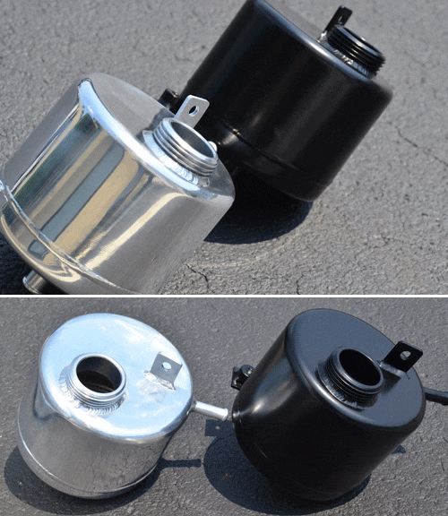

150 plus shipping. Right now I'm trying to find a machinist to make an aluminum bung so you can use the factory cap. Factory mounting points and internals and whatnot. 3/32 thick 5052 aluminum material.I'll have em pressure tested to about 30psi just for good measure.
WHAT?!?!? Amazing!
Keep us posted. I just replaced mine, so don't count on me for one, but interested in how this plays out.
Aron, if you start selling these, I suggest you start a thread and we sticky it.
Aron, I replied on FB too - but dont check it often. If these get produced, and work out I will buy one. Count me in as a committed purchaser.
Note - I would pay extra to have AN bungs welded to the hose connections as well. I will be upgrading a majority of my plumbing in the future and would rather use threaded connections vs barbs if at all possible. So this tank would work well for that "final" setup.
