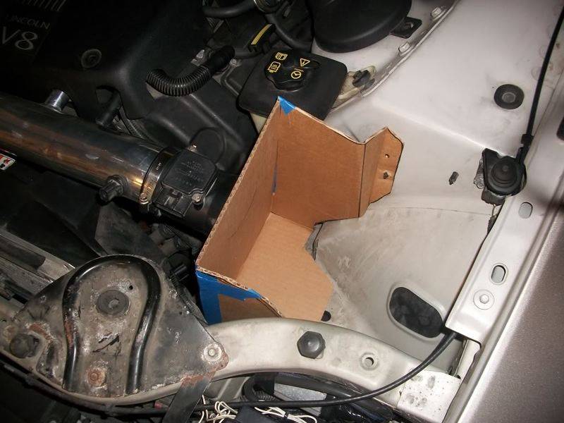

After some further modification I realized the hole you see to the right of the heat sheild was a hole I drilled to install my origional stainless steel heat sheild. The factory air box mounting hole is just below the flat piece just to the left of the hole in the pic. I have drilled out the prototype heat sheild to be able to use the factory mounting hole. This will be much cleaner looking and easier to install for the buyers.

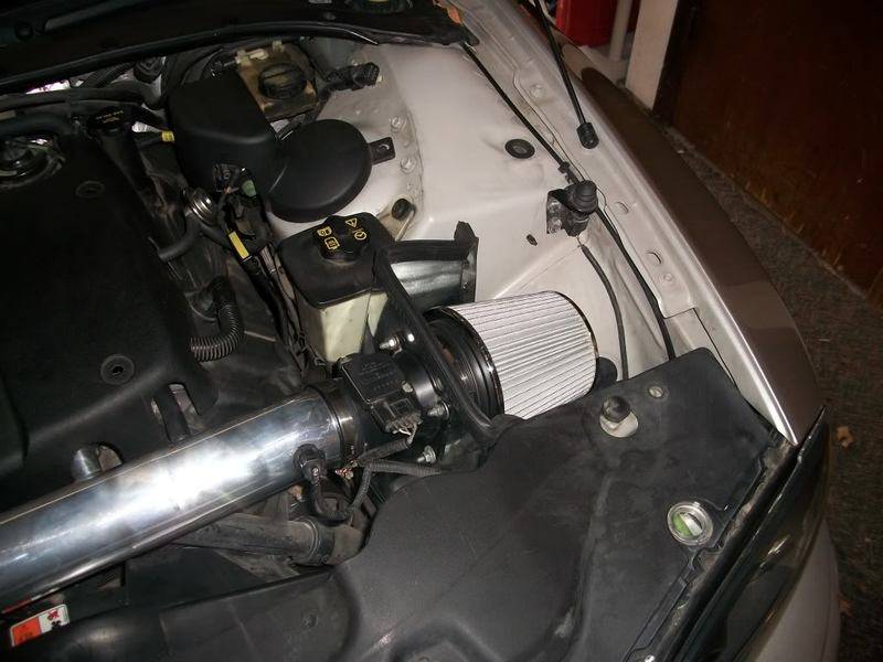

The Spectre 8145 mounts to factory MAF perfectly. Here's some pics of mine mounted with the K&N RC-3600 Filter.
I've got pretty much this same setup, except I'm using a Spectre air filter. I was planning on mimicking your wire stabilizer. :) This heat shield is gonna rock!

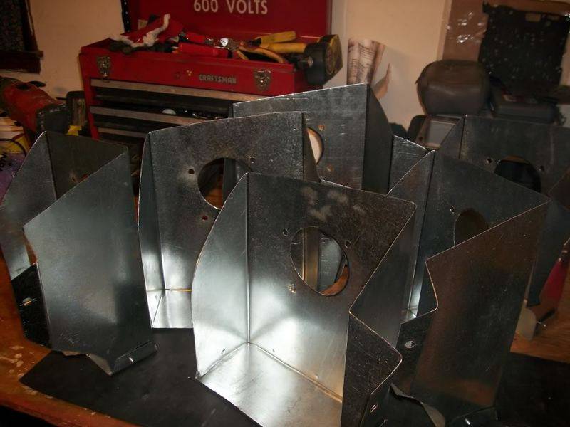

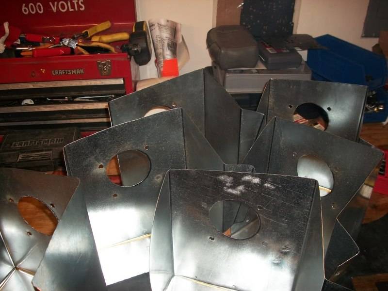

I have been working on a few heatshields. I have around 6 near completion and I will likely have either confirmed it will fit an LSK tube or have one specifically designed for the 1st gen with the LSK tube by this Saturay or Sunday. The 2nd gen with factory intake tube will soon follow. I'm going with one design at time so I can focus on making quality pieces with the best fit possible. Here's pics so far.
Very cool! You've been busy!
That would be great if the stock and LSK tube work with your heatshield (but I think the LSK tube is longer with a downward pitch and extends the filter towards the fender more, at least it looks that way in the pictures). I'll buy one if it fits both. Otherwise I will have to wait for $ for the LSK tube & your heatshield.

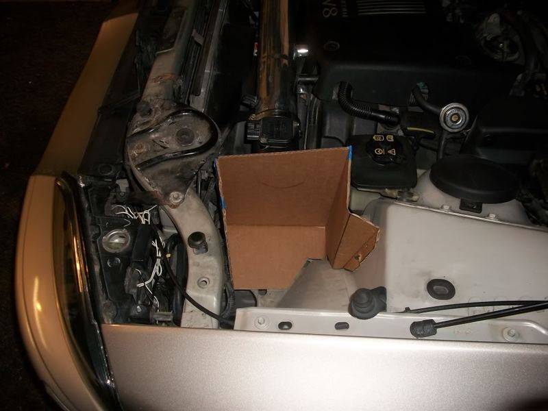

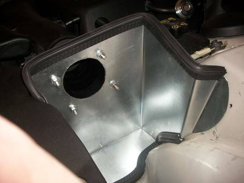

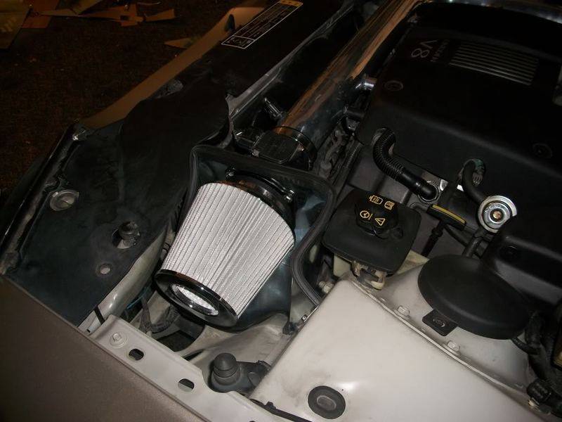

G-RELL came over today and we made a template for the heat shield for the LSK intake tube. I made the template with cardboard and then made a metal one from that. I used the origional metal heatshield as the permanant template and made him one for his car from that. The fit is very good as you can see in the pics below. He is going to send me the pics he took with his camera so I can do a full write up on the process. The good news is now I will have heatshields for sale to work for the gen1's with the factory intake tube and the gen1's with the LSK intake tube. Sometime next week I will be posting both of these in the for sale forum and will start a thread in the LS forum with a link to the for sale page.

That looks great, good work.
