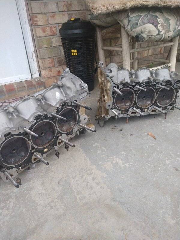

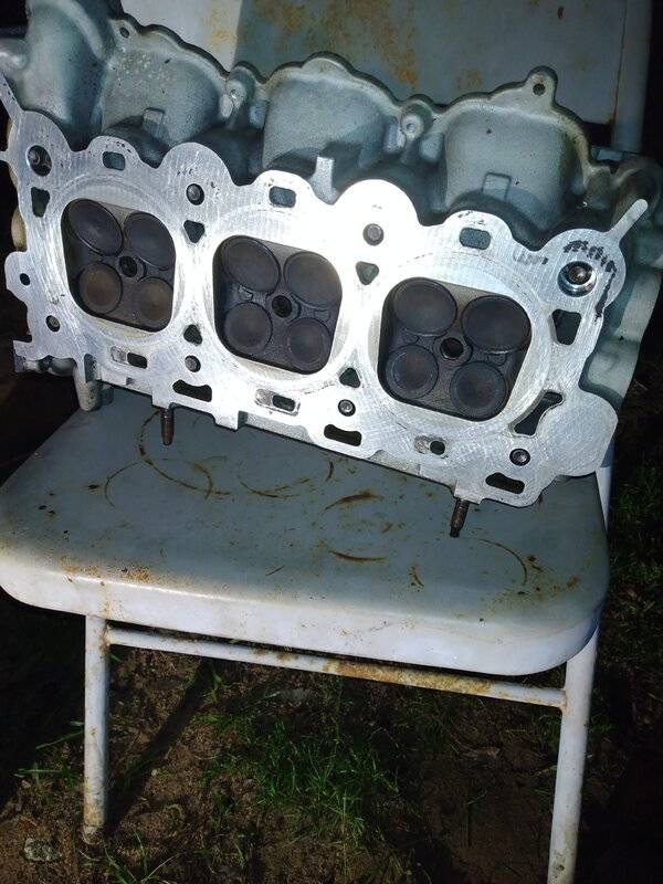

I do have to buy a straight edge and check the cylinder heads for warp but if they check out I'm going to finish my teardown and look for a decent rebuild kit .I drove it a few miles with that bars leak in it so my main bearings might have suffered some damage from the water mixing with the oil.

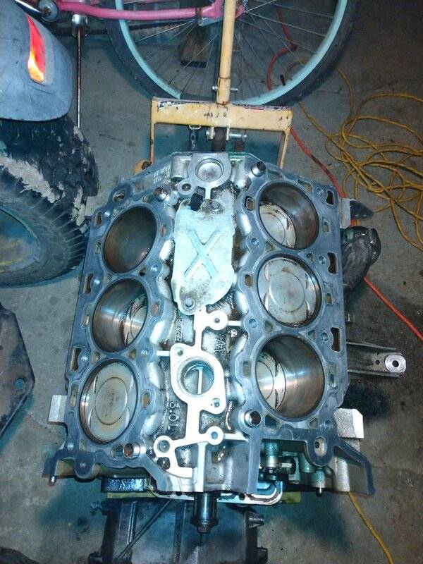

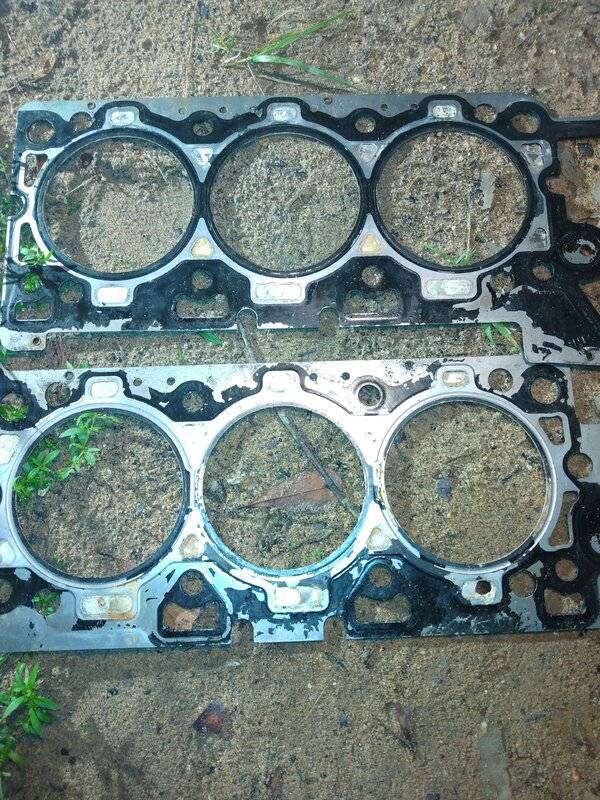

Got it all cleaned up and ready for the new head gasket!
I think I got it this time I pick up my head gaskets tomorrow and I will put it all back together and hope she holds this time.
