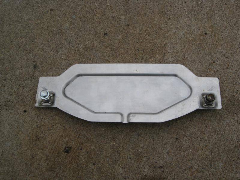

I already have the torx sockets, to drop the motor from the bottom. What worries me the most is the transmission. THose torque converter bolts are hard to get too, especially with no inspection plate like a 350turbo tranny. But yes i do need toools, and this would be a perfect time too save money and too find out were the vacume lines go on my other motor.
...... no inspection plate....... yeah........ hsave you just not even tried to look? Two 10mm bolts holds it in place or you can use the rubber plug on the drivers side of the motor.
Please post progress pics as you go, this should be fun to watch.
It's 2 8mm bolts for the inspection plate, and the T/C nuts are 14mm, trans bell housing are 13mm and the starter is 3 10mm, the trans lines are 7/16
actually the trans lines are 12 mm, nothing on the mark is standard even though standard will work, the car is metric.

No i haven't tried to look, there's snow on the ground here, it don't sit in the garage my mustang does. I was just stating from when i gutted a 94 mark viii. I did not even notice one, but we pulled it as one whole piece. Motor and trans together. This was a year ago too. Ill definitely have to take a look, and yes i am writing this down, excellent information. Well needed indeed.
lookie!! inspection plate.
