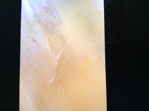

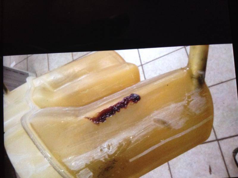

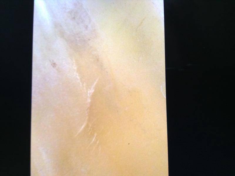

And I had some time today to get the LS back on the road. Did the degas bottle first which isn't all tht bad to change the 2nd time around. Probably 2 hours I'd guess..definetley learned a few tricks to get it off fast. Not sure how to attach pictures I'll try it but I think the degas was the problem. Had a couple cracks and just nasty overall.

Can you guys see the images I attached of the degas bottle in my previous posts?
