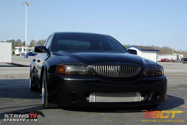

Check out the rear-end on that thing! I think the fenders and wheels are stupid, it would have been better with larger wheels instead of filling the gap with more body. Custom hood isn't bad. I would like to see details on the interior and electronics.

dude, this guy copied all my next mods, lol, yeah right. that is one of the sickest LS' i've ever seen. i must admit the wide body stand looks a little of kilter but i feel like it needed to be that wide to fit those beefy wheels/tires up under there. i could fit two of my wife's tires in there, lol. as far as the engine goes, i wouldn't even know what to do with a beast like that. all in all i think he has done a terrific job thus far and has not anything that in my eyes looks tacky or out of place. i would love it if someone with an D-SLR took the pics rather than those mobile pics. he does mention a magazine appearance though, so maybe that should suffice. great thread (subscribed)
Unless it has at least 750 HP it's a joke. There's a LOT of $$ tied up in that car and if it was possible to buy something stock for less $, there'd be no point to it.
The wide body 'kit', actually an extensive re-work, is necessary to fit the tires in place. Without the tires, the power won't get to the ground. Once more, just a joke!

Not 750 but close enough.
Just got done on the dyno with the Lincoln LS-R yesterday. We kept having issues with the blower belt slipping, but managed a 19psi pull at 745whp
If thats WHP then crank HP is roughly 855HP with rough est of 15% loss thru drivetrain.

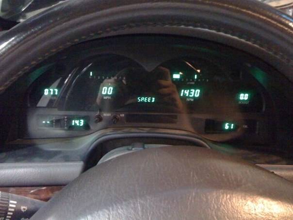

Hi, my name is Danny Smith. I work at Spec clutch and do all of the work on our cars here. I came to work here after some of the work had been done to the car, but I have been working on it for a couple of years now and I am responsible for getting it finished. It has been a really tough project and now that it is almost done, I am really starting to enjoy it. To answer some of your questions(I'm sure you will have more), it made 745whp and I think it was 540 or so torque @ 19psi. We were having problems with the belt slipping and the pipes trying to blow off, but to be totally honest, I was very happy to see it make it through the dyno session in one piece. I have several bugs to work through and once that is done, I expect a little more boost and rpm. Maybe somewhere around 850whp or so. This car is built for promotion and to be driven on the street, so that is plenty of power in my opinion. This is not meant to be a race car by any means. If it were, it would have turbos and much more power. As far as the interior goes, we had Dakota Digital make a custom digital cluster out of the stock one. It matches the stock radio and climate controls perfectly. I think it turned out pretty sick! As of right now, the interior is completely stock. We have some recaros being recovered and we may do some carbon accents, but that will probably be it for the interior. Right now, everything works like stock except for the climate controls. Only because I haven't addressed that yet. I have the a/c compressor mounted, but have not made lines yet. I have not even ran the heater hoses yet. The main focus was to get it running and tuned first. Have no fear, I will make it all work. The car has a Big Stuff 3 engine management, TKO 600 transmission(which I am lobbying for face plated gears.LOL), Mosier
9" rear solid axle. It is an 04 Cobra engine built by Sean Highland. The wide body is from a mold made from Ford's world challenge LS-R race car and is made from carbon fiber. Right now, it is the only one in existance. I am sure i left several things out. Feel free to ask any questions you have. There will be plenty of exposure on this car. It has magazine spots lined up and we will be promoting it pretty heavy as well.

Damn, dude. VERY impressive. i'd love to see the guage cluster.
