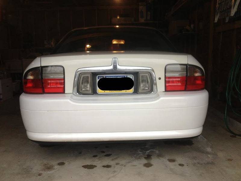

Very Nice BEN!!
Welcome to the Club :D
NOW PAINT THE REAR CHROME SURROUND!

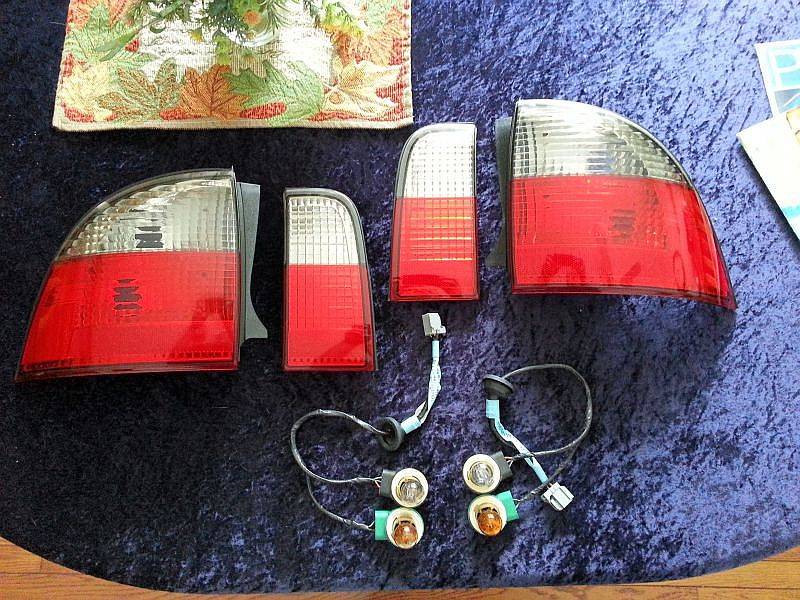

Tint is officially off the tails. Gonna buff them up later when I have time.
Thanks again mlara.
Looks great Ben, good job!
... Are clear bulbs for turn signals even legal? I always thought they had to be amber or red.
3156K Amber.
The first Gen rear turn bulb is only one filament and clear.
Noticed that when I pulled out the bulbs (3157K Amber) of the 04 two-tone tails I recently pulled from a yard.
Very Nice BEN!!
So this is what being in the club feels like :rolleyes:
Not just the surround, all chrome will be gone soon I hope.

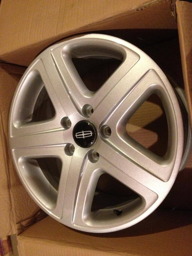

A member asked about my adapters so I figured I would post up the specs from when I ordered.
LS bolt pattern: 5x108
LS hub diameter: 63.4mm
Type: One piece adapter
Hub centric to car and Wheel centric to wheel
Thickness: 22mm
Stud size: 12x1.5
Center bore: 71.5mm
Diameter: 5 by 130

If you had a black LS they would be perfect IMO...but i still think they will look good. :)
I actually have been looking for something similar for my 20's...
where did u get them? (ebay im guessing) ...and if you dont mind measuring, whats the diameter in millimeters? I need something around 48-50mm
Thanks :cool:
Thanks :cool:
Yup, ebay. If you message the guy he will make them for you any size, any design, and up to 2 colors.
I got them domed because they look like gloss and it matches my wheels better. He has some that are plain vinyl, which I think mighta been better for me because my center caps are already kind of bulged.
