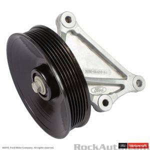

I "THINK" this is the idler pulley another member used on his V6... off an Escape.
Don't know... because I have never opened the hood on a Gen 1 LS an physically looked at the cooling fan pump system.
The part number for the above pic is YS243 at RA
