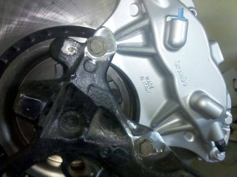

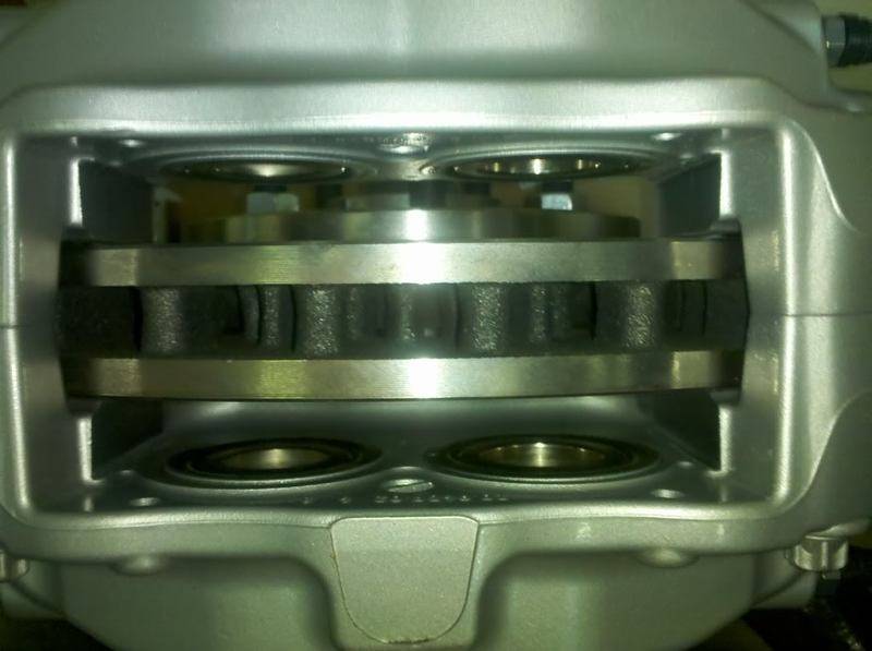

Calipers were new AC Delco units for a 2005 CTS-V from Rockauto $150 each and of course the 5% discount code. Rotors are just Wearever units for a 2007 GT500 from Advance, $50 bucks each.
2011s are 6 pot Brembos
Yea the GT500s use the same "caliper" but the mounting ears are spaced much further apart. If you check out Vintage Venoms conversion kit you can see how much they had to move the bolt hole. And you end up with a fairly thick spacer behind the rotor to center everything up.

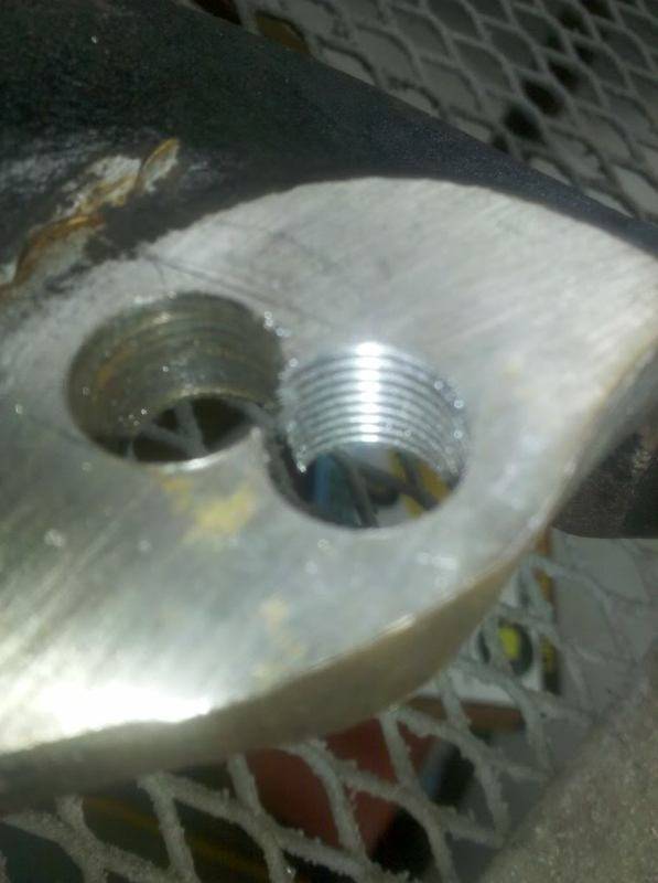

And I made the stupid mistake modifying caliper
Brackets and filled the old holes before getting a good
reference for the new holes so I understand why yours
aren't welded up yet
Slow progress day today. The rebuilt master cylinder for the 56 caddy showed up yesterday so I had to give it some love today. I did get the original holes tapped just need to cut some threads on some bar stock and make my plugs. Thread them in, weld them up, then mill it flat....maybe tomorrow.

What do you think the odds are those could be fitted to 13" rotors? Judging by your pics, it "appears" it's possible.... Hmmm...
i'm thinking move the 13" cobras to the rear and rock these up front. Nice job man
To work on a 13 inch rotor you would need another hole directly below the one I drilled. That would be milling pretty far into the spidle at that point. Also i am not sure how the swept area would line up (I don't have any 13s laying around to check). I am sure it would be possible but I am not sure it is worth it.

Ok guys got back to work on it today. I filled the original holes in so now for lack of a better term this spindle is complete. Even managed to get the spacing right on the money.
