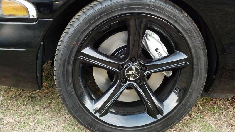

So I got this setup installed on the Mark yesterday and took it out for its maiden voyage. Braking force does seem much stronger now, the car will seriously nose dive under hard braking so I will have to work on something to get some more bias to the rear ( I am thinking 4 pistons and 13 inch rotors should work :D )

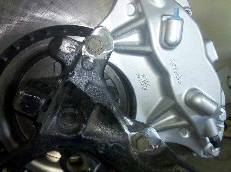

Ok guys got back to work on it today. I filled the original holes in so now for lack of a better term this spindle is complete. Even managed to get the spacing right on the money.
Isn't that caliper on the wrong side? The blue plug is in the hose banjo bolt hole and the bleeder is on the bottom :)
Wouldn't matter for mock up purposes, but no it isn't on the wrong side, look again the bleeder is on top.
-Alan
Ya, it looks correct to me... Just looks like the knuckle is rotated to about 4 o'clock.

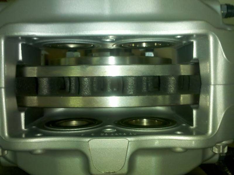

So, to make sure I got this. Mark spindle, Cobra hub, GT500 rotor, CTS-V caliper.
Well yes you have the parts correct, but look through the pics there was a fair amount of machine work needed to make this combination work.

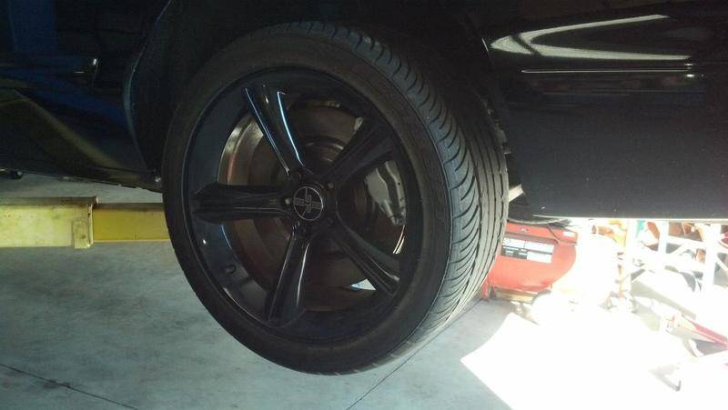

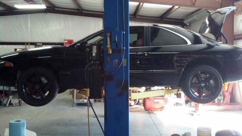

The saga continues, got the rears mocked up today. Sorry for the horrible pics the camera on my phone is junk.
