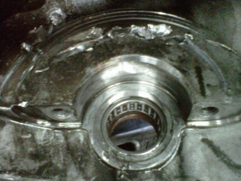

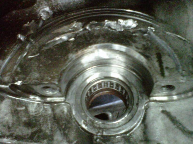

I just rebuilt a 04 Cobra pumpkin. All new bearings, seals, clutches and 4.10 gearset. I even made a jig to mount the pig in a vice and a spreader.
I want to steal his cover.....
