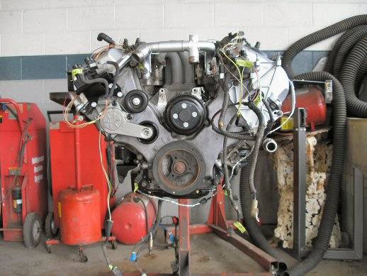

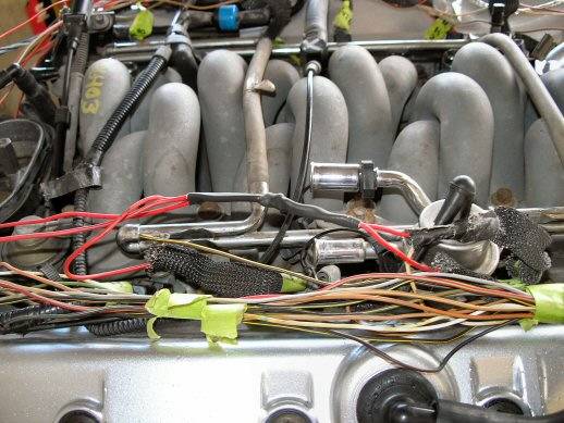

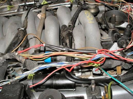

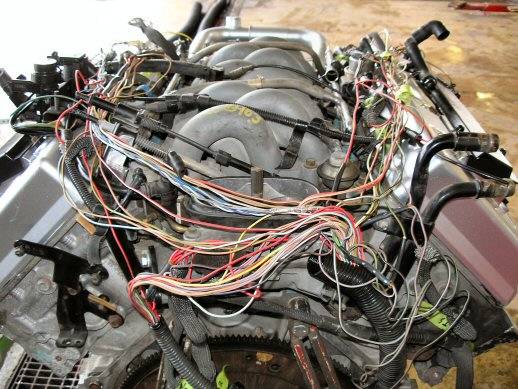

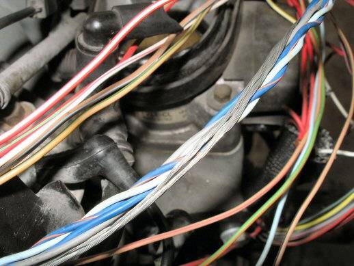

spent a couple hours tonight "re-looming" the eng harness, its has been fun, on the t bird setup the harness runs to the middle of the intake manifold then branches out all over the engine from there, so i had to rewire all the power feeds for the injectors (the power is constant and the ground switches the injector on and off so the power side was a 9 wire splice dead center of the intake)so i made it so it would splice at the rear of the eng not a big ball of crap just sitting on top of the intake yipiee!!! i got most of it done im gonna route the crank poss sensor down the driverside and under the front of the eng and around due to the cam poss sensor and the crank poss sensor are both "shielded" (wrapped in foil so there is no electromagnetic noise so to say) and they each have 3 wires each sensor (2 for the sensor and 1 bare one for the shield to ground on) so theres 6 wires, not too bad but they are braided all the way back to the firewall bulkhead, and there is plenty of wire if you un loom it from the coil pack harness and everything else on the pass side and run it over to the driver side.

welcome to wiring hell
not too bad really it looks worse than it is, just had to re-splice 13 wires so far and a lot of untangeling, just lots of labeling, and dont worry these pics are just the temp set up, im just figuring wire length and taping it with masking tape then i will remove the harness from the eng and wrap it in tape im sure vr4 has some of it lying around too (from the ficm harness recall on the 6.0) then cover it all with convoluted (sp?) tubing and make it all purdy
pic 1 : d.s. loom
pic 2: mess back neer throttle body
pic 3: braided hell, crank poss sensor and cam poss sensor wires
pic 4: new routing of crank poss sensor down d.s. and across bottom and up
pic 4: pass side injector power feed splice (no more 9 wire knot in center of intake)
pic 5: driver side injector power feed splice

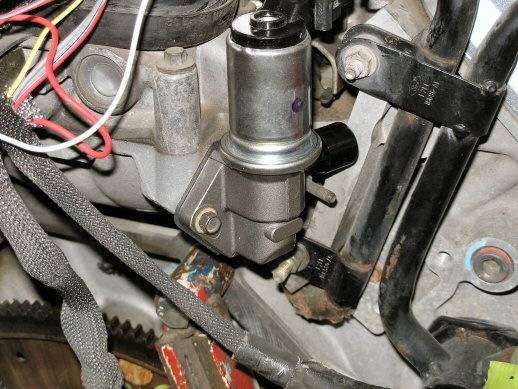

pic 6: new iac (i dont wanna mess with this after the engine is installed)

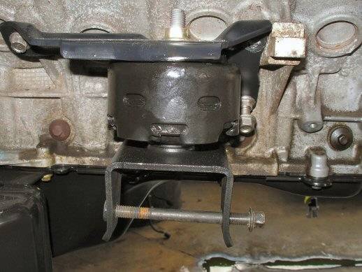

pic 7: new solid rubber motor mounts
pic 8: just another pic of the front notice the spaghetti

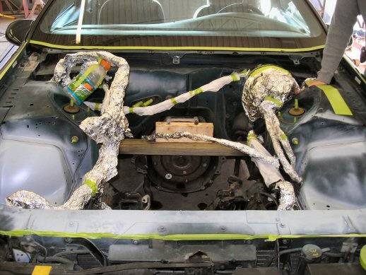

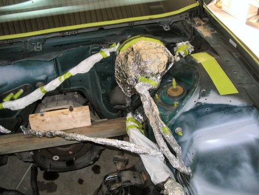

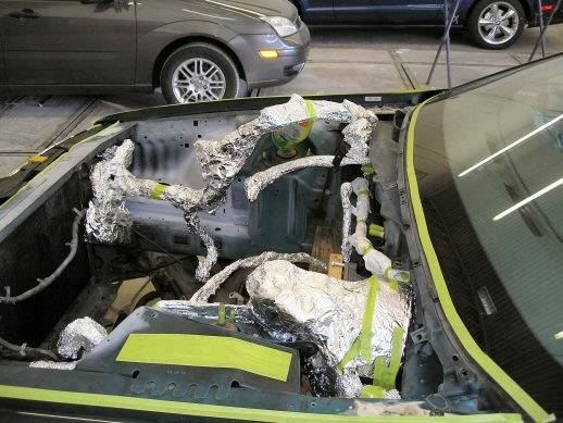

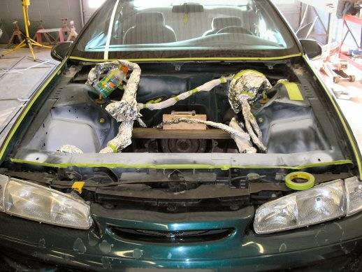

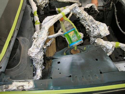

just covering the veh wire harnesses and our body guy says foil works good so we are gonna try it, but so far it goes on easy just wrap it around whatever and squeeze and it stays no tape, no bs, and it "should" be in the booth around 1 tomorrow and we are just painting the eng bay now just because the eng is out the body will be painted later unless you like peeling clear coat than its the paint job for you and the last pic is "fun with wiring"!!!!
