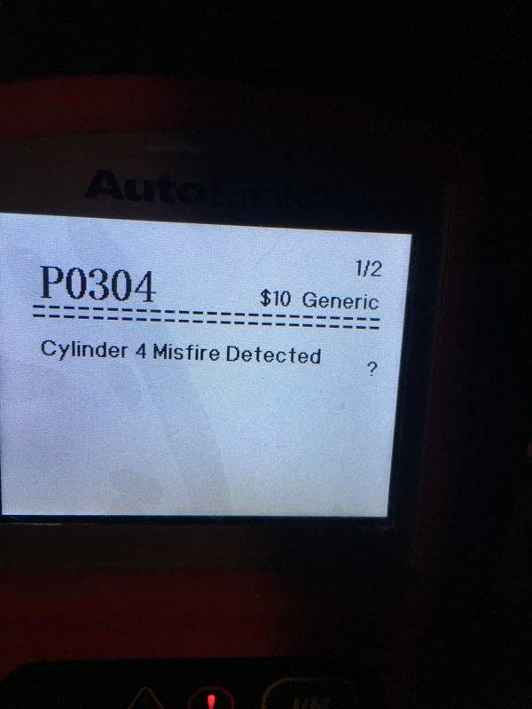

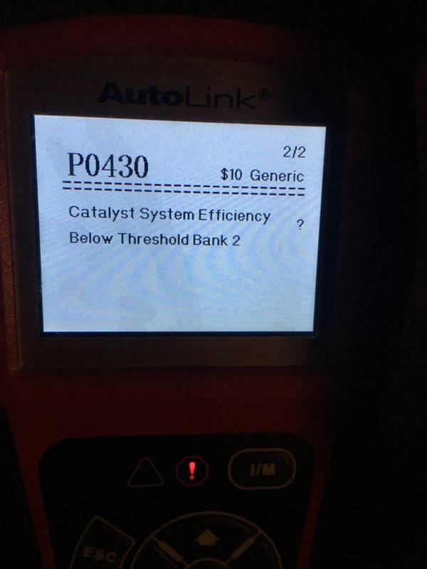

Codes P0430 & P0304. Any help resolving these would be greatly appreciated.
ErnieG22
Jul 13, 2016
118
4
Fresno
Hi, '02 LSE V8...I fixed my overheating issue, but now I'm pulling codes P0430 & P0304. Regarding the misfire code, is it likely a coil? Or bad spark plug? Or both?
Regarding P0430, is it likely the O2 sensor on bank 2?
Also, my car didn't start last night after watching a movie. I went back to jump it and it fired up right away. I had the battery, alternator and starter checked today and they all tested good. Any idea why it wouldn't start? I went thru some deeep water the night prior after a heavy downpour of rain, not sure if that has anything to do with it not starting. But it fired up today no problem.
Thank you for your time.
View attachment 828569146 View attachment 828569147 Hi, fixed my overheating issue, but now I'm pulling codes P0430 & P0304. Regarding the misfire code, is it likely a coil? Or bad spark plug? Or both?

Did you use motorcraft coils? Or an aftermarket coil? I was thinking about NGK...they're $14 cheaper per coil.
When you are having a problem, such as misfire, replace the coil and the spark plug at the same time. Make sure the gap is set to 1.0mm exactly.
It could be an 02 sensor, but I think think that it will be. It's more likely that the code is correct and that cat is shot due to running too long (doesn't take long) with misfires. Motorcraft only, on the coils.
Misfiring has been going on too long and is ruining the catalytic converter.
He could attempt to replace the downstream O2 sensor but that's same as shooting the messenger. It's only doing it's job and reporting that the CAT is below efficiency threshold.
Myself, I wouldn't focus on the downstream error just yet but rather complete the following steps first.
1) Replace all Coils with OEM Ford brand.
2) Replace all plugs with NGK Iridiums. (verify proper gap)
3) Replace fuel filter inside drivers wheel well.
4) Replace Air breather element. (filter)
5) Clean Mass Air Flow sensor.
6) Full bottle of STP fuel injector cleaner in full fresh hi octance tank of fuel.
7) Reset and clear DTC codes using OBDII tool.
Fix the misfire first, see if the Catalyst DTC returns.
In a quick tinny nutshell ... you coils are old and tired, weak and misfiring, it's refered to as "Marginal Failing Coils", while it misfires, it dumps raw fuel into the CAT's. This is not good!
If indeed a V8 (was not mentioned), and I'm only presuming so due to cylinder 4 misfire code, you need to be aware that Marginal failing coils, specifically #4 which is closest to the PCM, will and can destroy your PCM from RFI. It can and will also throw it into ETC fail safe limp home mode (GEN 2). At such time it will store false Throttle Body and Position sensor DTC's (codes). It has nothing to do with anything Throttle Body related (GEN 2). It's the PCM puking on itself because it's getting a jolt through it's circuitry from RFI (Radio Frequency Interference). The PCM is not shielded enough and coil 4 is close to the point when it misfires badly, it sends current distortion to the nearby PCM.
Before PCM and/or CAT's are destroyed, you need to RE&Re all coils and plugs immediately.
There is no way around this and it needs to be done properly not some half fast job with only replacing one or two coils with a few fresh plugs. The whole thing needs a refresh for success. You can try aftermarket cheaper coils if you want but I wouldn't recommend it.
Also do take the time to investigate why coil 4 is misfiring. The Lincoln LS is well known for issues related to coil shorting from either rain water, washer fluid or oil getting down into the plug wells.
SEARCH is your friend, I've documented troubleshooting this issue and posted RE&RE articles all throughout this forum. I can dig them up for you if you are having troubles with the search function of this forum.
Need to state year and engine when asking for assistance going forth.
