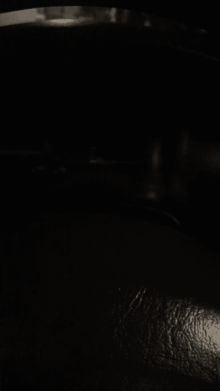

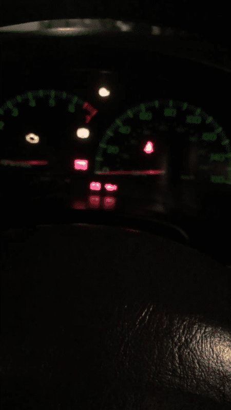

Yes, the entire cluster goes dark/blank. In the run position, I all the lights are on. I have a video. Can I uploads a 20 second video?
Here's stills from video
I think you have to post videos somewhere else and link them here. The PATS light is not on the cluster. Your picture does not show it. It's on top of the dashboard, at the center, at the base of the windshield. It's the one the flashes periodically when you arm the alarm. It should come on solid (red) when you first turn the key on, and go out when the engine starts. It will flash rapidly if the PATS is preventing the starter from engaging. After the rapid flashing, it will flash out a two digit code a few times.

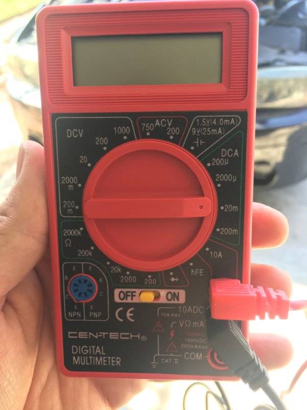

Do I put it on 20? Where is the power port?
Yes, 20 VDC is a good range.
There is a power port behind the ash tray door. (You could use the lighter socket instead.)

Where do I put the leads on the power port?
DCV 20
Your test leads are in the wrong places. You will blow fuses and may cause damage to the meter.
Black needs to be in the bottom spot ("COM"), and red needs to be in the middle one ("VΩmA"). Leave the top spot open. (The way you currently have the probes is invalid for any sort of measurement.)
Touch the black probe to the metal rim of the power port, and the red probe to the metal center contact down in the power port.

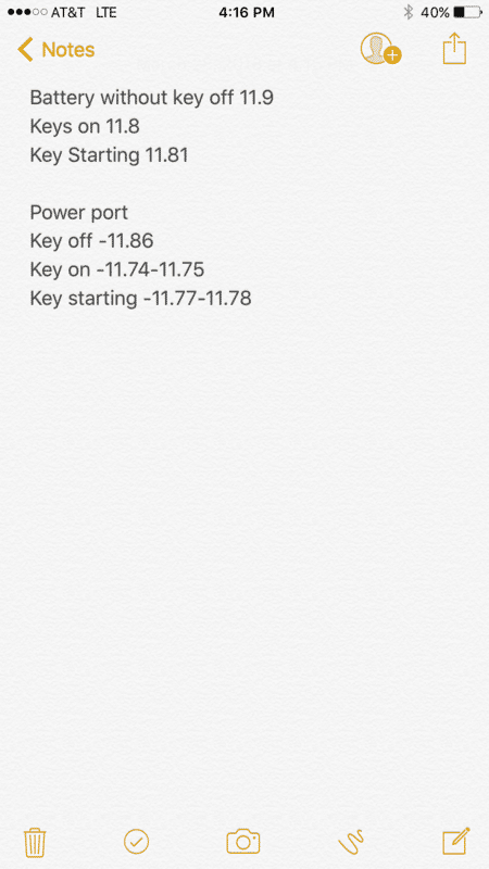

Your battery is fully discharged, but it seems like you have some other problem going on too.
Anyway, need to correct the battery first.
A battery with no load is discharged if below 12.6 volts (normal temperature range)
A battery with a minor load is fully discharged if below 12 volts
A battery below 10 V (except for momentary high current loads) is damaged.
Also, you switched the red and black probes around on the power port.
