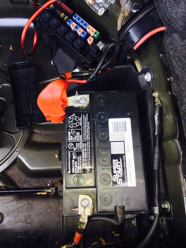

I Hope this will fix the issue ...quick, easy and inexpensive ...Update...Bad battery. Going to install new battery when I get home.
Installed and still no start. Doing the exact same thing. Should I disconnect the battery? I'm fearing my engine may be toast from driving in deep water. I hope not..I Hope this will fix the issue ...quick, easy and inexpensive ...

Tested the battery posts with multi meter and the reading on the new battery is 12.16. Is this normal for a brand new battery?Shouldn't.
It's not fully charged (assuming this is room temperature), but probably okay.
Good enough to do the starter voltage tests...
Not sure if it was fully charged. I just assumed new batteries were, so that's why I reported my multi meter readings to you.Do you know that it was fully charged before. Most new batteries are not.
