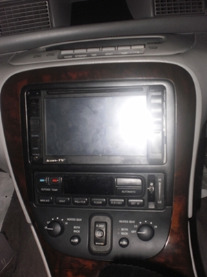

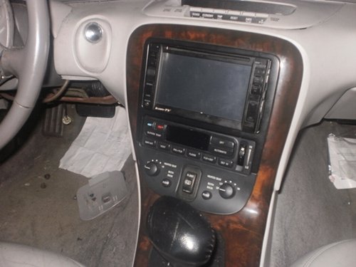

Well I went to try and drop my tranny again last night but my transmission jack is'nt working! My brother has my floor jack and it was too late last night to go and get it from him. So I just took out my factory in-dash cd player and installed my double din touch-screen unit! It has navigation/dvd/cd/mp3/sd card/ipod/tv-tuner!!! I did not get to finish it because I had the wrong harness! I had half of the right one. I still have to get the part for the speakers since the car has a factory amplifier! Walmart or the auto parts stores do not have the right harness! So I am going to have to find the right one. Does anyone know which harness it is that I am going to need? Like the brand/part #/contents of kit?
