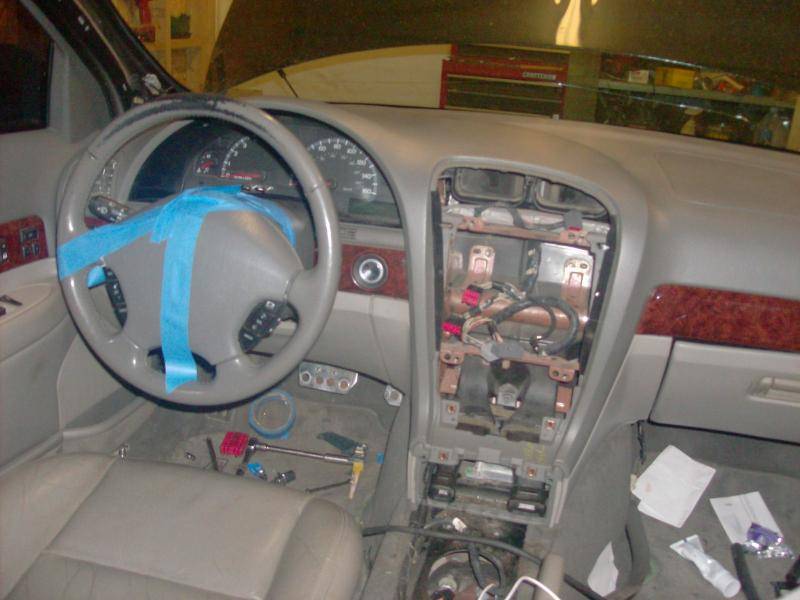

Dash Board Removal Thread
I had no idea what it looked like under there. Huge thanks for the photos.

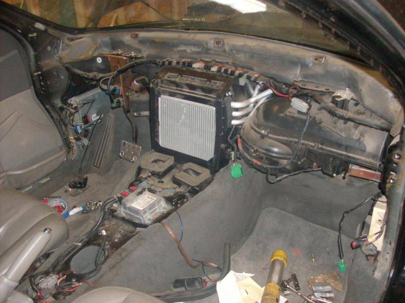

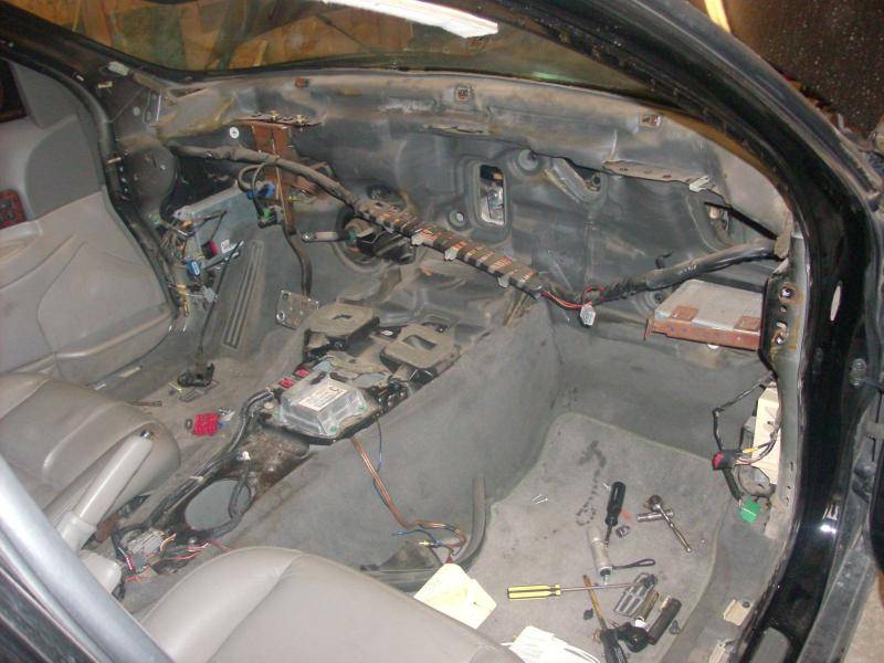

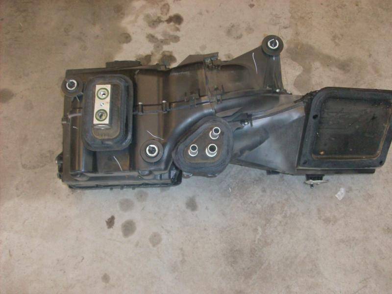

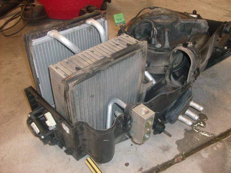

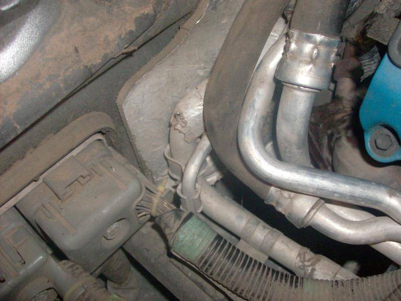

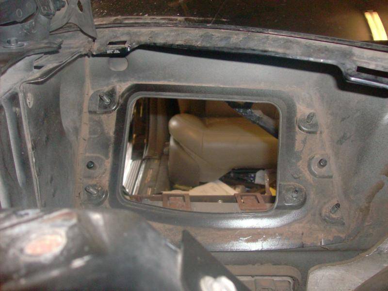

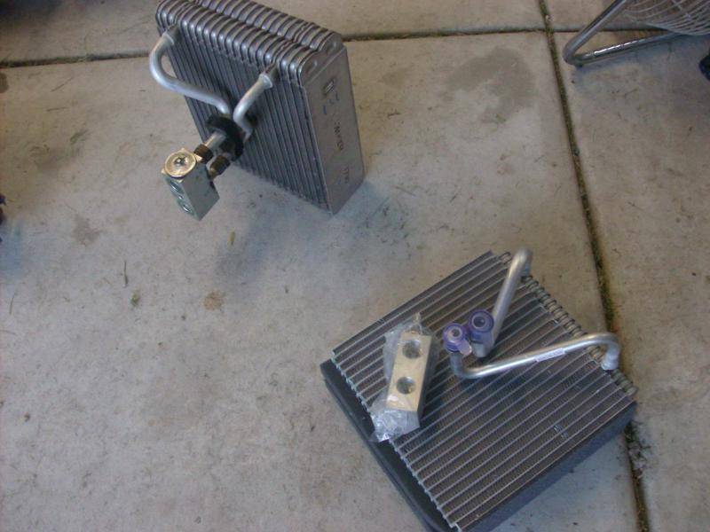

After much fighting to just get 3 nuts off that gets the evaporator box out, it's finally out.
In the first pic one of the nuts that holds the box on is behind that rats nest of hoses, for the life of me I could not see what was holding the box up from coming out, so...if you do this, look here.

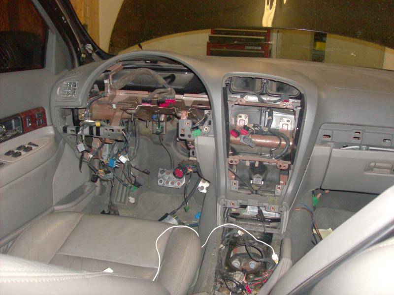

I have the Heater/evaporator box back in along with the dash. You almost have to have two guys to get the dash back in, which I did, it's awkward and HEAVY!

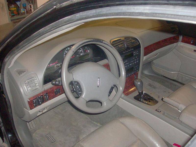

Finally!

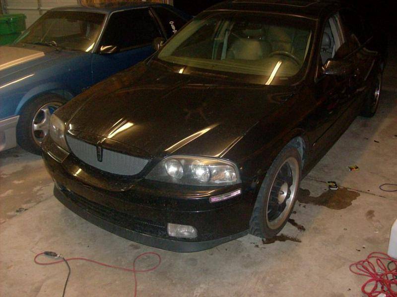

Ok, I actually had some free time tonight to finish this sucker up. I'm glad to report that everything works as it did except for one exception, the shifter indicator lights on the console are not working. Must be a plug I forgot.

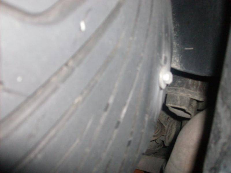

After taking the car out for a test drive, which was so nice to be back in, on the way home I hear a metalic 'tap-tap-tap' from the back of the car. I pull into the drive to find a sizable bolt in the tread of the drivers side rear tire. :rolleyes: I guess I'll get that plugged.
Oh, I will do a quickie write up on this if you guys want and all I can say is that I way over did it on tearing the car apart. In not doing it before I had no idea, but lets just say I didn't have to disassemble as much as I did. Oh well.:p Now, time to get the A/C charged and this thing cleaned up!! :steering
