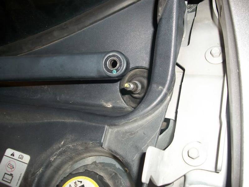

2) Remove the windshield wiper arms. Pull off the rubber cap and remove the nuts. Pull up and down gently on the arm until it comes off. You may want to mark the position of the arm before you remove it so you can replace it in the exact same position.

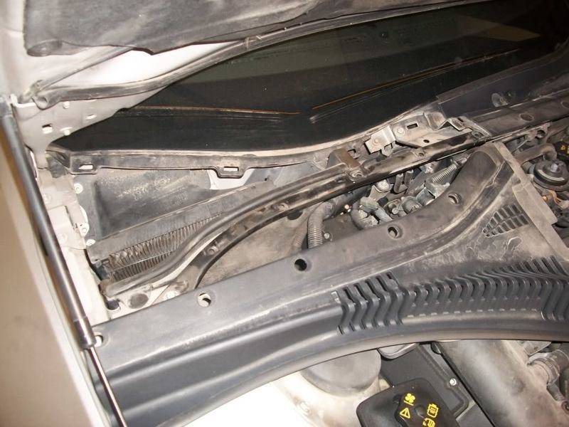

3) Remove the pin clips that hold the cowl covers on. Push in on the center and they will come out. Remove both cowl covers

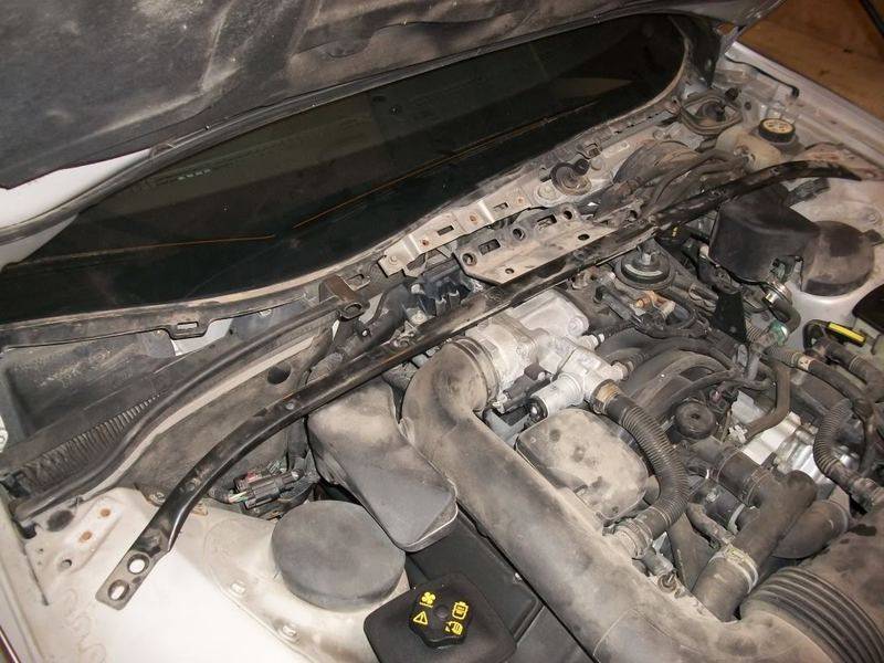

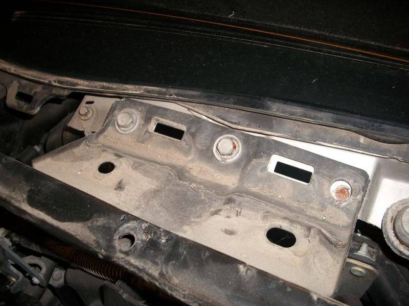

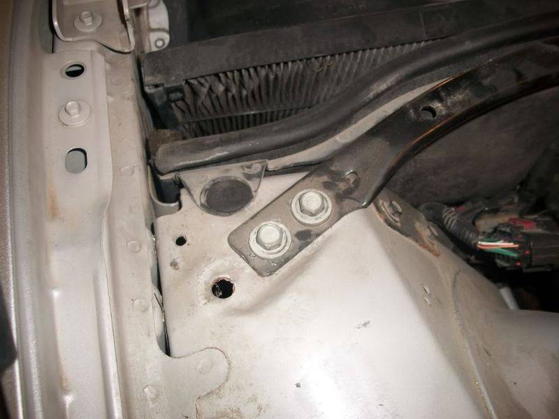

4) Remove the 7 bolts holding the strut tower/firewall brace and remove the brace

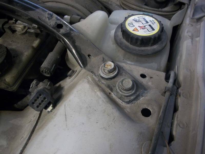

5) Remove the 2 bolts and 2 hoses on top from the degas bottle. Leave the bottom hose attached to the degas bottle

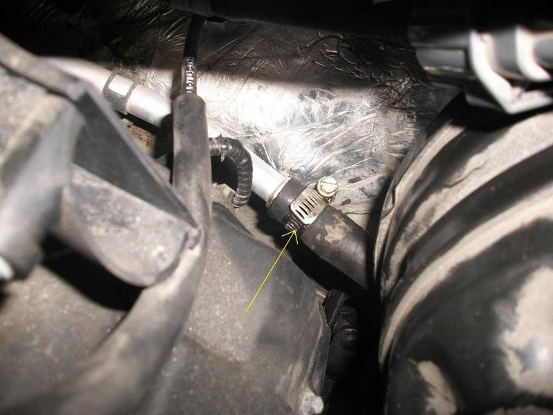

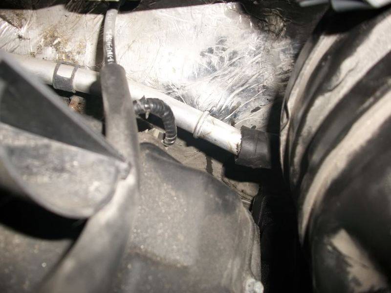

6) Remove the pinch clamp on the lower hose from the heater core pipe located behind the drivers side valve cover. I would throw this clamp in the trash and use a regular wormgear hose clamp. The factory clamp is hard to put back on considering its location

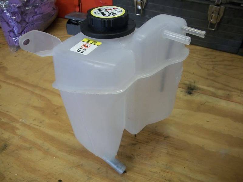

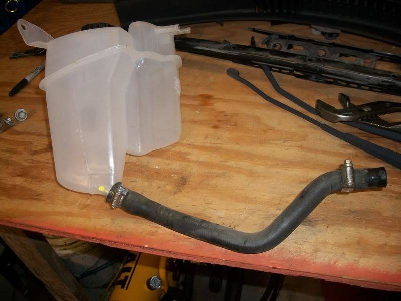

7) Install the lower hose on the new degas bottle in the same position as the old bottle
8) Install the new degas bottle and connect the lower hose to the heater core using a worm gear hose clamp to make it easy

The hose against the firewall was the hardest part of this whole job at least for me...
+2 I agree, definitely the worst part. I think a pair of channel lock pliers would have made it easier but I couldnt find mine, so I tried just about every other tool I had, Some may have gotten thrown when they didnt work. :shifty:
tip: If you remove the drivers wheel and the wheelwell liner..you'll see a hole in the fender sheetmetal that gives you perfect, clear access to that hoseclamp.
in fact, when I purchased my Degas bottle new from the dealer a few years back, it came with a new lowerhose attached to the bottle.
The clamp I was referring to was the clamp behind the drivers side valve cover. I leave the hose attached to the reservoir when I pull it out of the car but I didnt realize you could get to the other clamp from the wheel well. I never looked around alot when I changed my fuel filter.
I guess you can probly reach that lower hose clamp from the wheel well. It looks pretty tight though.
