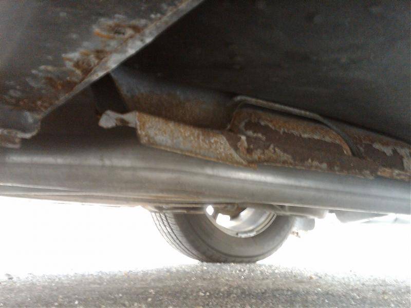

Bought the car sight unseen (my bad - and it hurts).

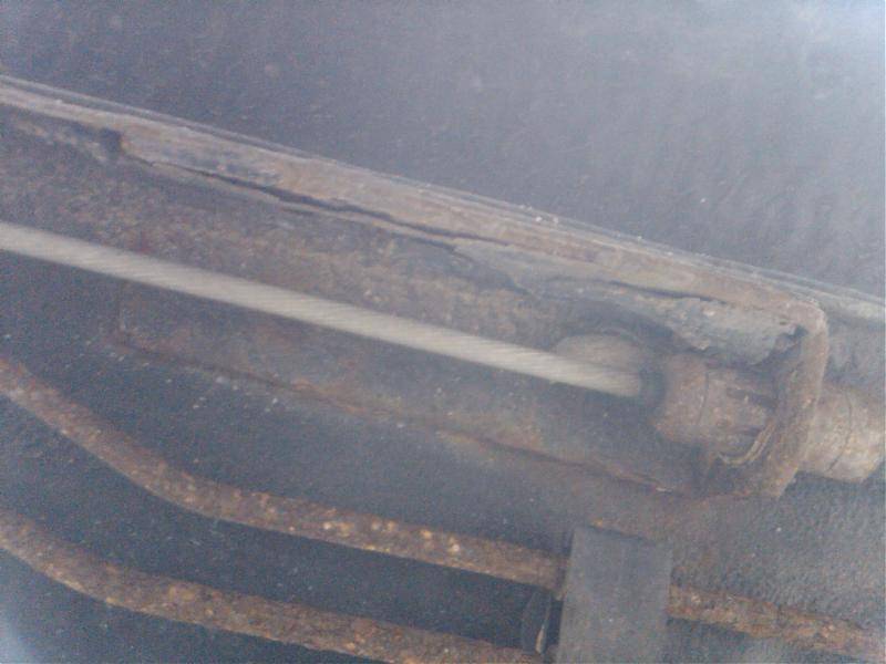

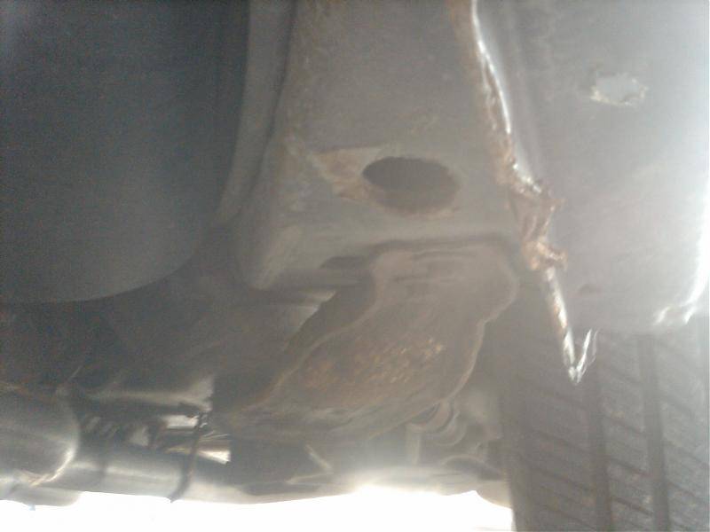

Finally had a mechanic and body guy look at it - the unibody is rusted beyond repair!!! Splitting and stretching. Car is apparently worthless. I am going to puke.
Was led to believe it had minor rust underneath as any 13yo car would and it was nothing to be alarmed about.
I am going to take it to another place that my company goes to and see what they say.
12k down the drain purchase and parts. But what really kills me is that I don't have a mark VIII now! I am actually crying right now. Quietly of course and to myself!:bash:
Oh how life sux! I am an idiot!*owned*
I can't sell the car to anyone without telling them about it. So therefore I will not be recovering much. Try to sell it for under book? and see if max can take back the parts.
This is all I have of the underbody.
When I bring it to the other place myself I will take pics.

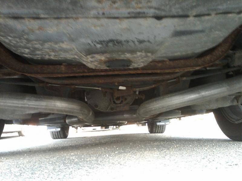

Well it does not look THAT bad. Maybe its the pics, but the rust looks normal for a 13 yo card driven in the winter. Of course letting it sit all winter did not help - unless it was garaged?

Unibody and frame is splitting. I am told it would need to go onto a rotissary and completely redone.

I've lived with rust my whole life... that kind of stuff is just another day in MN... I just don't see how it could be that bad being only a 96...

I'd like to see some more pics... the few pics you have so far looks like every other Mark I've been under in MN, and none of those were even close to be ruined, or unsafe to drive...
Lets put it this way. Mine is worse, or appears so. But its all solid. I really hope its not as bad as the first guy says.

Also keep in mind these cars are galvanized so surface rust is usually that. Most car guys dont know that. Experience does not equate to wisdom.

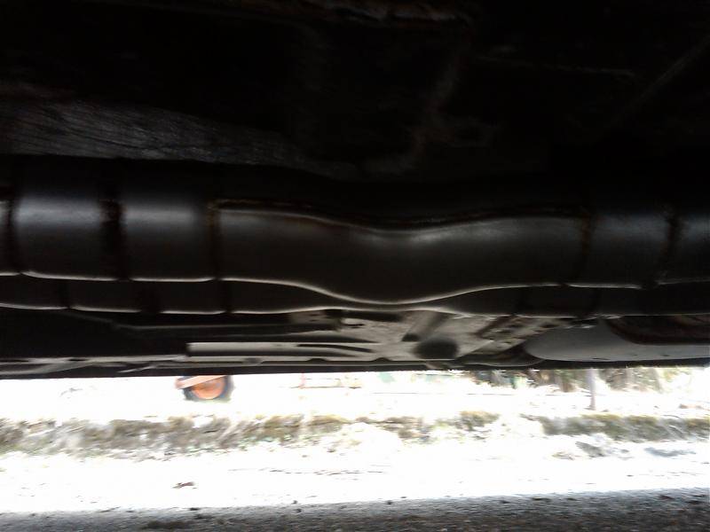

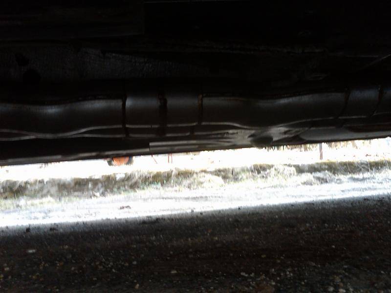

I'm going to agree and say from the pictures it doesn't look that bad. That said these rockers can really go to muush.
Does look like the rocker seem is pretty soft and crushed in that one pic. 5th pic

I'm sorry but that guy must have been full of it. There is a lot of surface rust but I doubt its as bad as they say. I'd like to see pics of the stretching. Worst case you cut out and weld in some braces, would end up being stronger than stock. My car is the same underneath, driven every winter, and very solid. Get more opinions You could drill into areas to check but make sure you spot fill them afterwards. Thats a very nice looking gen 1, don't loose faith yet.:cool:
