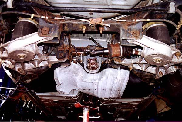

I have seen FAR worse rust then that man, WAYY worse and the cars are still on the road.
Johnny Nocera's was the worst I ever saw and it ran and drove fine and is still on the road I believe.
Here is shot of his rear.

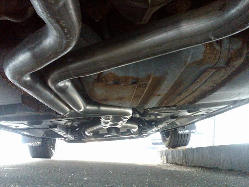

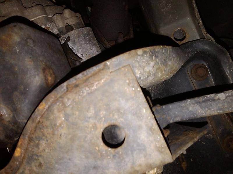

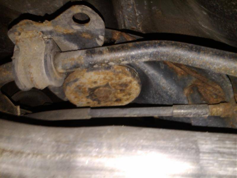

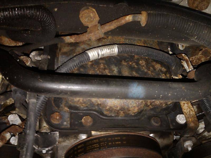

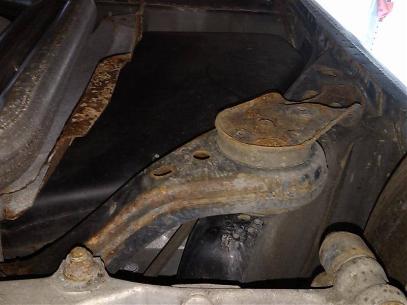

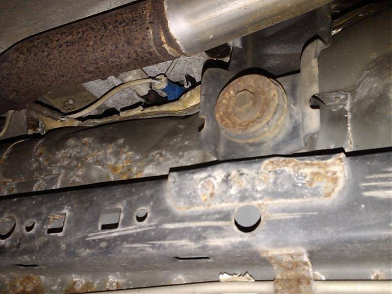

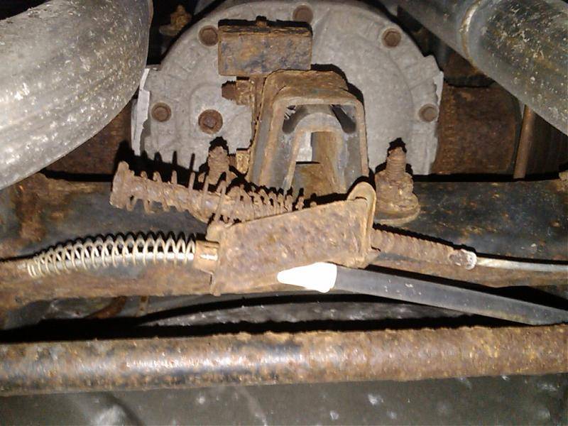

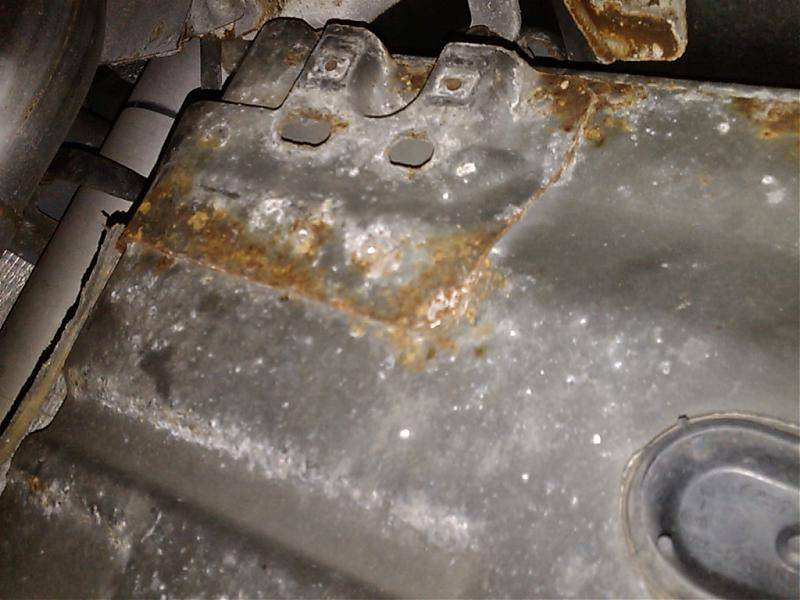

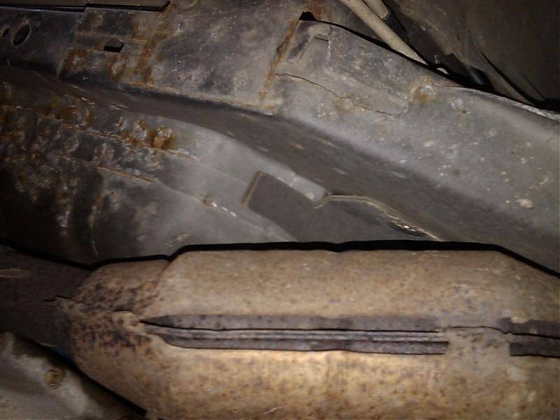

I'll be snapping some pics tomorrow when it's up on the lift too. I looked underneath mine and it kinda freaked me out a bit, and the brake lines... I think mine looks worse.
I'm gonna go pull it up on the sidewalk curb w/ 2 tires to lift it and crawl under and snap a few now.
I agree with everyone else - it doesn't appear to be THAT bad. You should see my 94 winter "beater"... its almost scary. Yet it still runs and drives fine. Although I would also be extremely pissed and scared if I were in your spot too.

LMAO, your crying over that? You should see under my truck. Whole thing is surface rust, panit falling off. Still solid as hell, 10 years old. Just do like I do every year. Power wash the loose stuff off and paint it. If it were bad you would have holes rusted thru somewhere under their. Looks like a clean car IMHO.
You gentlemen could very well be right. I am holding judgement but asking for advise. The place I am taking it to tomorrow is strictly collission repair and stopped short of all out refusing to do my spoiler as they are too busy. And I didn't push it. But they will look into this issue for me as they are great people (hopefully - but I know the family. LOL). So like I said i'll take it for a third oppinion. first is Geno's who said it is clean, then my guy who brought it his guys place because the rust alarmed him when he got under it. Tomorrow another and if need be yet another.

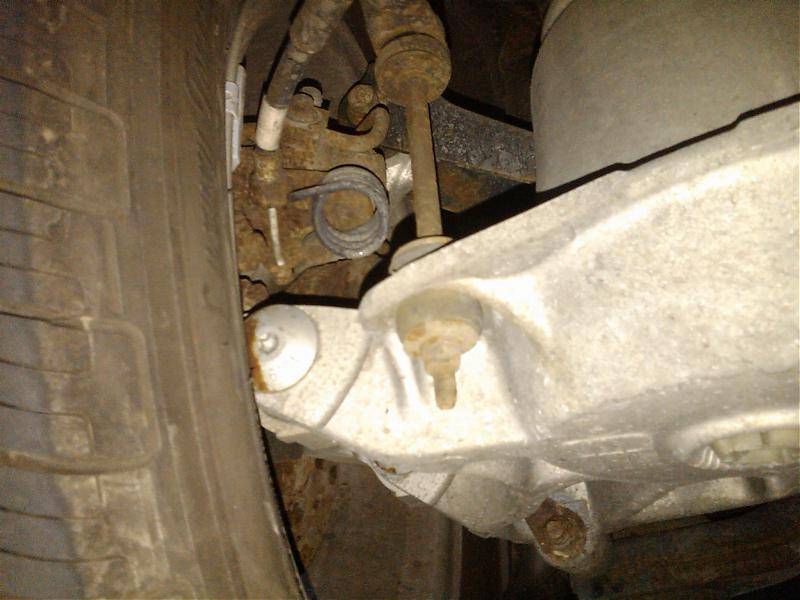

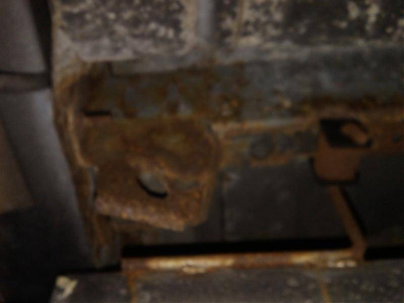

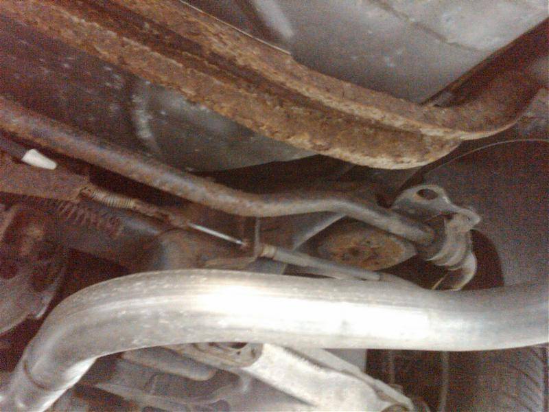

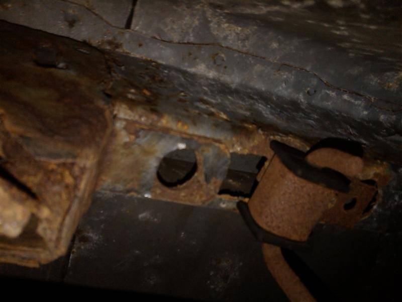

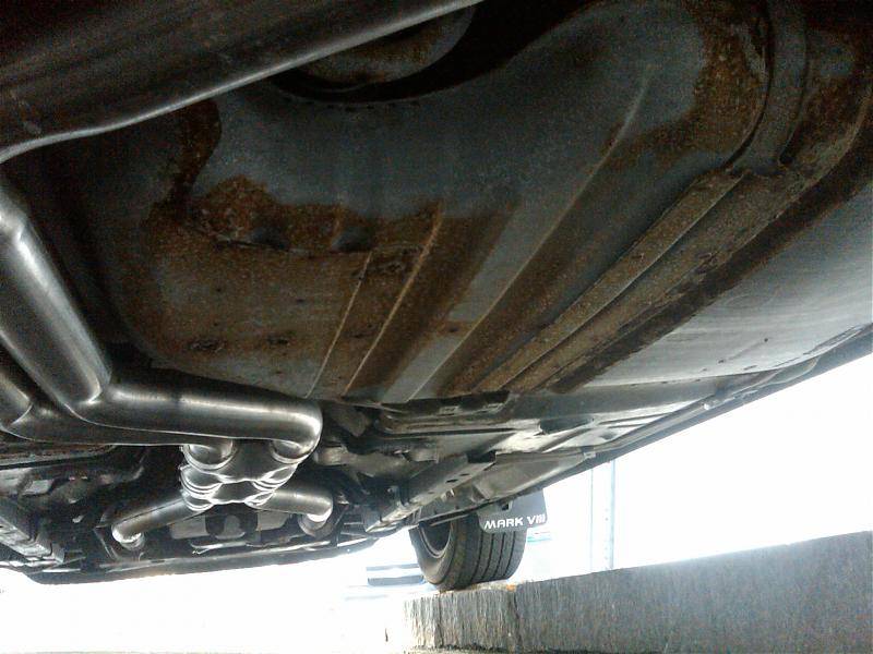

I just snapped a few pics with my city jack system here at work - it doesn't look too bad to me either but it's kinda hard seeing it without being lifted and with a crappy cell.
To me it really does not look that bad mostly looks like surface rust. I would just get it on a lift and pressure wash the heck out of it and just hope for the best. Good luck.
dude i lived in mass for 27 years, i started tearing marks apart in 1999, and did northern marks till 2003, that is nothing, absolutely nothing to be worried about at all, it just looks bad, its all surface cancer, as far as your unibody splitting lmao, stop going to get the car checked out, people ar gonna say some funny shyt to you because they need income right now, everyone is hurting, the only thing that is going to split your unibody is getting hit by a train, get that out of your head, its not gonna happen. your car looks brand new compared to the marks i used to take apart in new england. granted you have way too much money into it between upgrades and the actual price you paid, but none the less the car is fine. just pretend you never saw the underside of the car and block it all out, you are good to go man.
