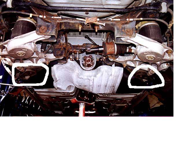

speaking of rust, what are these pieces i got circled? mine are pretty rusted out, is there anything you can do to replace these?

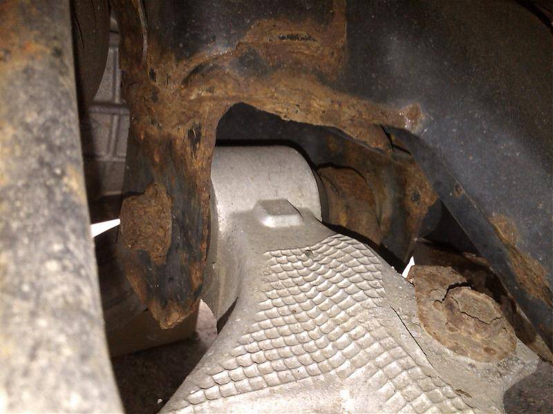

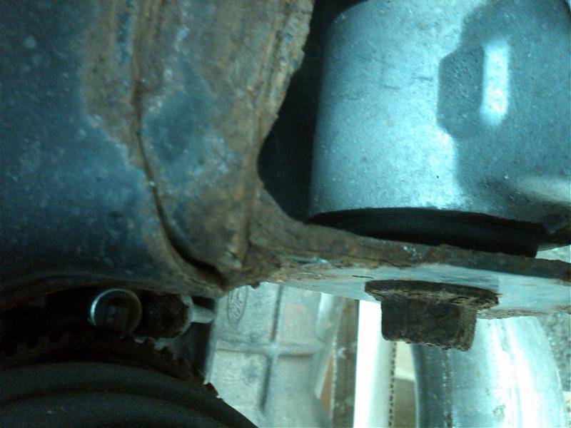

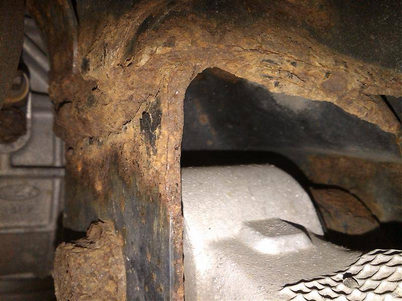

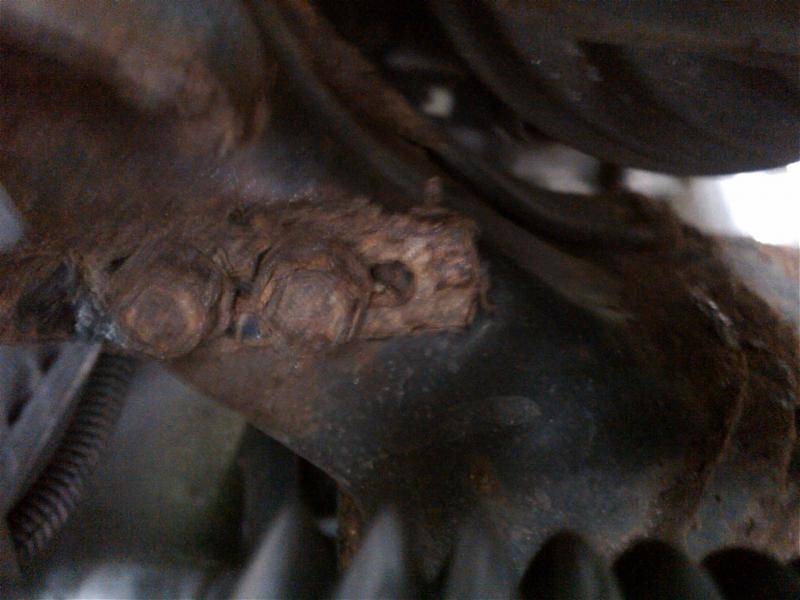

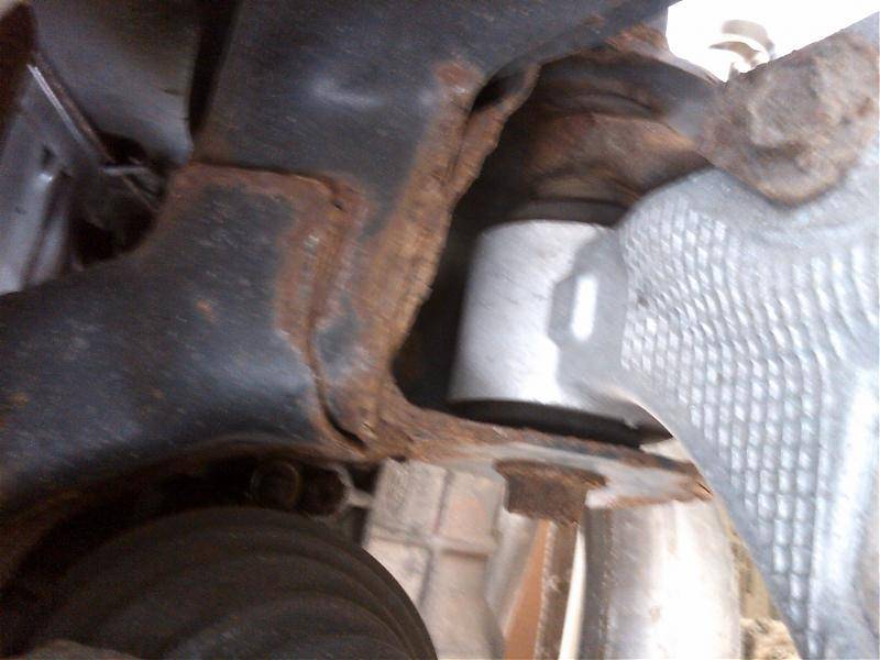

As a mechanic and former body repair tech, let me assure you that that is definitely nothing to be worried about. The oil pan looks like it might need replacement soon, so keep an eye out for one of those in case it starts leaking on you, and for peace of mind you might want to replace the brake lines, but other than that, you are fine. The big thing in the center that looks so bad is just the fuel tank heat shield. Clean it up and spray some undercoating on it, and it will look fine. Even if it rots completely away though, it isn't structural. Also, the rear sway bar end links look like they will break if you ever try to take them off, but that is a cheap and easy fix, and not a safety concern so no worries there. The only thing I might be at all concerned about is the brake lines, but from the pics it is hard to tell exactly how bad they are. But they are a pretty cheap fix compared to what you have into the car, so you definitely aren't F*CKED. Cheer up, and start enjoying the car.

ya got some surface rust that for sure.with the pics u have poated you really cant see any penetration of the rust.you need to get the car in the air and do some measurements.(a-symetrics)from what i see right now without true structural damage you might want to begin with getting it in the air,remove tank,dissasemble suspension,wrap drivetrain,tape up lines and have it blasted clean.then go from there.slag from age is to be expected,and unless the car has been in a major accident i wouldnt get rid of it.with what you got in it your really just a hop-skip-and jump away from having it the way it should be.dont get rid of the car it looks to clean.
didnt see you last pictures.it looks ugly i know however its trully a easy repair.again for what you have in it you might as well see it through.at least you know what you have then.i would use a porter power and tie it down to a rack and realign all the joints,then brace them front and back if possible and weld it tighta9after i had it blasted.tape it up from the rockers leaving the drivers door open and remove what i told you earlier.have it ready and have it somewhere it can be blasted from underneath.then go from i fortunate my car has been garaged by a lincoln service managers wife most of its life.
To be perfectly honest if not blunt. You bought a car that was located not ONLY near an ocean, but in an area known to salt thier roads in the winter time. This type of corrosion is to be expected on a 13 year old car, and the only way to help it is to blast the area clean and coat it like these people have been telling you to do for a while.
You bought a used vehicle made of steel which at last check...............Rusts. It's a fact of life, nothing lasts everything is turned to dust eventually.
