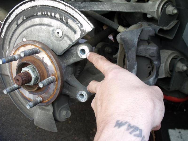

221??? Damn i think my tq wrench only goes to 150 or so?? The two caliper bolts im pointing to in the picture were a complete :q:q:q:q and thus cause my knuckle carnage lol, grabbin a drink and going back out, un-bolted that bar(tie rod?) towards the rear, lower control arm is next. I need to find some wd40 or pbblaster first tho.

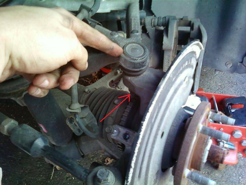

Alright Ill do that then, for the upper control arm, do you have to remove it from the body or what? I cant get that sob off.
no, there is a nut under the top that comes off, then you pop the ball joint out the top...but it may spin...which usually means the ball joint is bad...
the actual stud has an 8mm head on it so you can hold it while unthreading the bolt.
I suppose you could take the whole control arm off, it should still fit in the press.
BTW if you do take it off, when you re-tighten the control arm bolts, make sure everything is at ride height or it will squeak.

The nut is probably accessible from underneath. I don't remember though. Been a long time since the LSD install.
under it...not under the cap, look under where that piece connects with the spindle.
