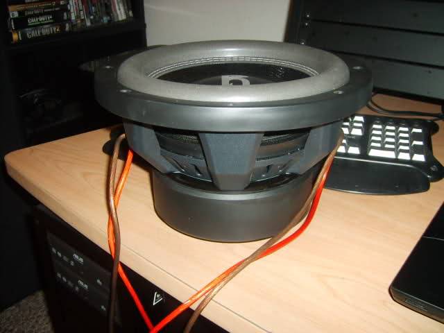

Heres mine i took it out because i was gonna send it in to get the upgraded model but im a bit low on funds this month due to the recent no start issue i was having:
Geez, what guage you running there? I have 16 guage speaker wire right now lol.
Nice sub too, btw.
yea, your gonna want to kick the up to at least 12 Awg, i used 10Awg just because a 10 awg amp power kit was the same price as the 12 awg speaker wire and i didnt need 30 feet of it.lol
damn black, you better be careful putting that beast too close to your computer, if you run HDD's, strong enough magnets will wipe that sh!t clean!:eek: also good to see your a COD fan

my gaming tower is at the bottom with dual 640gb hd's and laptop is to the right. also have a server and a backup machine in the closet.
Damn, you guys notice everything! That's why I usually point it out first or am very aware of what's in my pics!
man i really need to hurry and find a new house to buy, i need one where i can have a big garage and be close enough to town to get broadband, i just built a killer computer than can only use for playing campaigns or 3D modeling software, its kinda sad to just see it sit there, not conected to the real world, i cant even get a good enough phone signal to tether to:(
