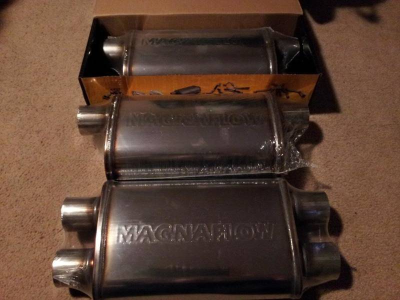

I think the Magnaflows I got were between $175 and $180 for both and the inlet and outlet are offset to the side so that the muffler itself can be tucked way up in there.
Kinda hard to tell in this pic but they will tuck in out of sight.

hey nolimit, i can't tell from your previous pictures, what offset did you buy for your 2 rear magnaflow mufflers, are they center/offset or center/center. I'll be watching this thread as you get it installed, make sure to take pics of the rear mufflers and tail pipes. Need to know which offset mufflers to buy to make sure they line up with the tail pipes and exhaust tip cutout on rear bumper.
They should line up just like DLF's. Everything back there is the same stuff.
