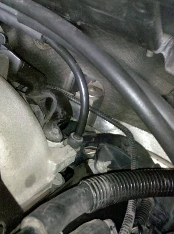

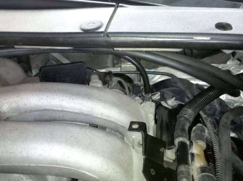

Heard the sound of a vacuum leak today that I hadn't noticed before; it might have already been there and I missed it. It's coming from back here
When I jiggle the vacuum hose that leads to the tb back there, I hear the noise change a bit. (tb, running lean... connection? probably.)
Can't see back there; what can I expect?
You only ordered the PCV valve and not the elbo? Make sure you get the elbo and I recommend getting the rubber connector that you see in that picture as mine was cracking pretty bad.

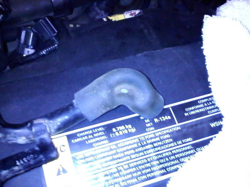

This is what my elbow looked like:
It wasn't leaking yet, but it was cracking so I replaced it anyway.

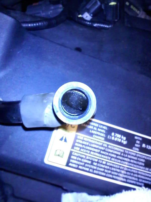

Working on the PCV elbow tonight.
Good news: discovered that the PCV elbow did in fact have a hole in it, most likely causing the lean banks 1 & 2. Also, got started on the valve cover gaskets tonight. Enter bad news... while cleaning up for the night, being only halfway done (d-side valve cover gaskets changed, plugs replaced, etc.), we replaced the valve cover and started pulling tools, bolts, sockets, and other odds and ends out of the engine bay, and my buddy decided it would be fine to set the hood down on top of a few rubber hoses hanging over the fender. Problem is, one wasn't rubber, but hard plastic, and when he set the hood on it, it broke. It was the PCV hose (from the intake manifold to the PCV valve). I'm assuming this is a dealer part...

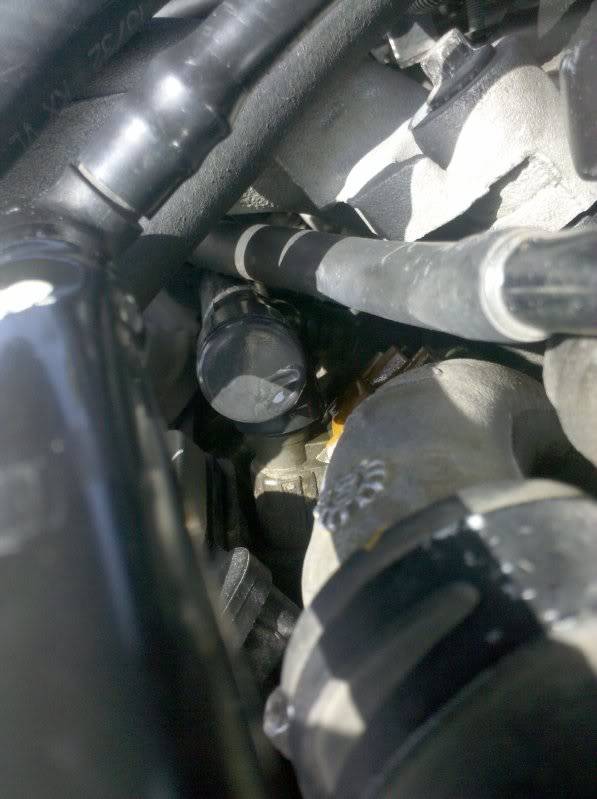

Also, temp gauge reads at exactly half give or take a needle's width once warmed up. However, the heater won't get hot. I'm afraid to even use the word warm. Could this be related to me plugging the hose that broke on me last week?
I'm pretty stumped on all these problems, guys. Any help appreciated.
It could be related to the broken hose, because it is part of an active air removal system. You need to purge the air out of the system more. Did you bleed coolant at the hose with the slotted screw plug by the brake booster? Did you let all of the air out of the black plastic bleeder where the hose barb broke off? That should cure your water temp issues, if you can manage to get the remaining air out. Unfortunately, that throttle body warming loop is also used for burping the system at all times to the degas bottle. With it no longer working, a perfect air purge at refill time is needed.

Mine reads about a needles length under the halfway point. milehighmikey is right, it's going to be harder to plead the system with that line off but I haven't had a problem with it. I turned my heater on high and bleed from the bleeder between the brake booster and degas tank. With engine running I took the bleeder cap off until coolant flowed regularly. I then let the engine warm up more and did it again just in case more air would come out. Remember it will be hot now.
Does the bleeder screw where I have the broken hose piece come all the way out? I was twisting it, it was spinning, but wouldn't move up or down. Also, the heater never got hot.

I had the same problem, that's why I told you how I did the one by that brake booster.

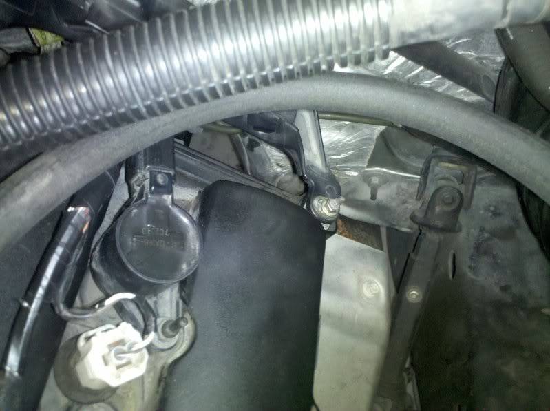

The oil is only leaking from a very small portion of the valve cover, specifically from where the bolt that is nearest to the firewall and on the right side of the right bank. I'm thinking that that one tiny part of the gasket didn't get pressed in all the way...

On the oil leak, is it to the right or left of center? Or is it centered?
It's coming directly from around that back corner bolt. I put some gasket maker on around the corner. Hopefully that takes care of it.
