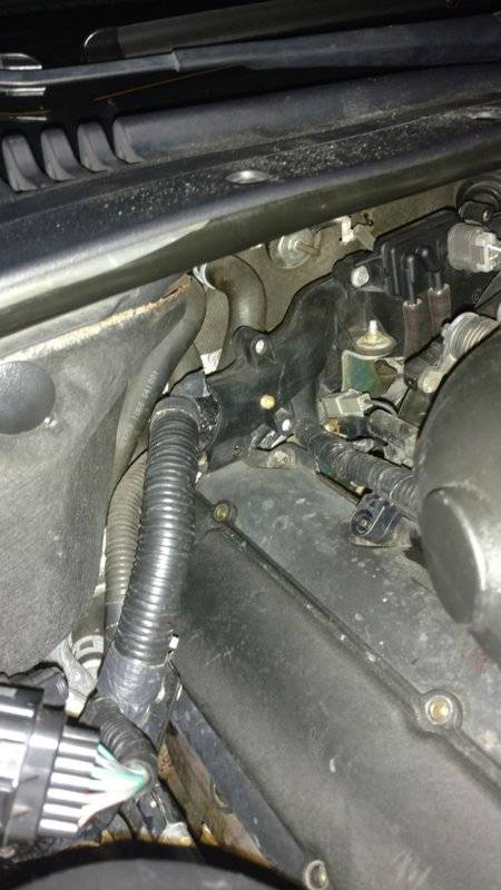

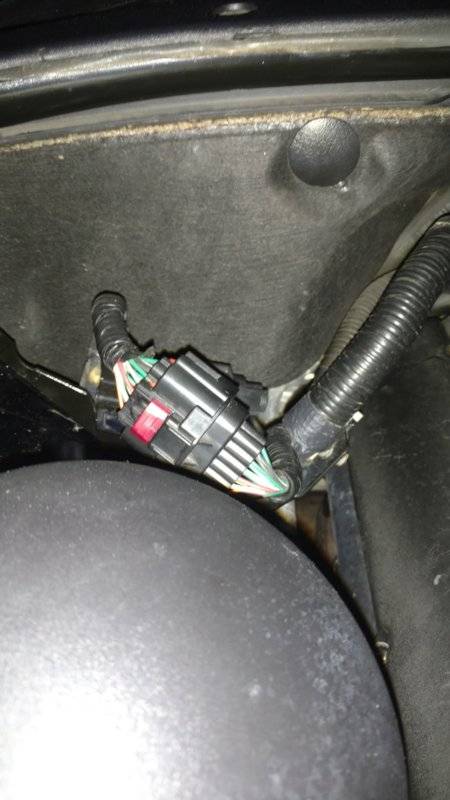

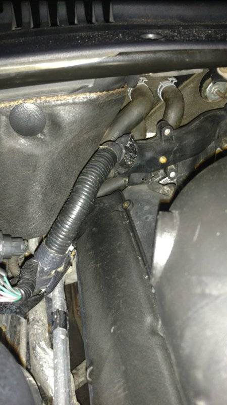

Well....I was under the hood this morning once again looking for the elusive air leak which could be the troubles to my woes...anywho went to start the car and just kept cranking and didn't fire up at all...Listened to make sure the Fuel pump started up under back seat so I could rule that out...started checking fuses ...Engine compartment fuse box first...grabbed the manual and went down the long line of fuses and sure enough pulled out the COP'S fuse and it was split in two...damn talk about lucky lol! Anyway I was wondering if you could do me a solid and take a picture of the back firewall passenger side so I can see where my long ground wire is suppose to post up? Just to give you an idea of where it is it's already posted to the top black metal crossbar that goes across the back ...I believe the cowl seats on the bar I'm talking about ...thanks again ...let me know if you need me to post some pics of the ground wire if you can't find what I'm talking about...its nice you have a 2001 LS V8 we have the same reference in a way...Thanks a million
Sure here you go hopefully this is what you meant. Sorry that I did not see this till just now I had been waiting all day to get a transmission pan gasket changed out. My other one had got some sand in it and it caused it to leak around the front bolts. Funny thing was we cleaned it really well when we changed it a few weeks ago. Almost wondering if that shop that I had trouble with did this some how cause they tried to say they had taken my pan down then the next thing you know they denied it. I had no leaks prior to them touching the car. I would honestly not be shocked at all at this point though if they did. I replaced the gasket anyway just to be safe. Also funny thing they claimed I had metal in my pan or drain plug but when we got it down there is not a trace of metal in the filter or the fluid. Gotta love these scam shops. But in other news I have an appointment tomorrow to get the car checked out and they will be most likely replacing the injectors. The Transmission shop also said today my injectors are highly suspect.
All good news ...glad things are falling into place...I think I see it in the first pic...that bolt sticking out of the fire wall is that silver ground wire posted up with a nut to that bolt? The nut was gone on mine ...I have a extra one so I can connect it back on the bolt if that’s where it goes ...just let me know whenever you get around to it ...no rush ...thanks for the pics I see where the harness is bolted down now also ...the previous owner of my LS jacked the harness up pretty good I think ...not sure what he was trying to do but if he or a shop had to replace something on the back firewall or whatever they didn’t put it back together worth shit lol By the way my P0174 lean code went away now I’m just running rich and th DTC code P0172 is still showing ...a little progress at least ...I’m thinking my injectors are a major suspect also
All good news ...glad things are falling into place...I think I see it in the first pic...that bolt sticking out of the fire wall is that silver ground wire posted up with a nut to that bolt? The nut was gone on mine ...I have a extra one so I can connect it back on the bolt if that’s where it goes ...just let me know whenever you get around to it ...no rush ...thanks for the pics I see where the harness is bolted down now also ...the previous owner of my LS jacked the harness up pretty good I think ...not sure what he was trying to do but if he or a shop had to replace something on the back firewall or whatever they didn’t put it back together worth shit lol By the way my P0174 lean code went away now I’m just running rich and the DTC code P0172 is still showing ...a little progress at least ...I’m thinking my injectors are a major suspect also
Yeah the things the previous owners do..... or rather never do in some cases.... lol
Hopefully all goes well tomorrow and My LS will be road worthy yet again. I hope that you are able to pinpoint your issue as well. It seems to be a thing though on these injectors this time of year cause 3 shops I have been into in the last 2 days they were replacing injectors on cars.
