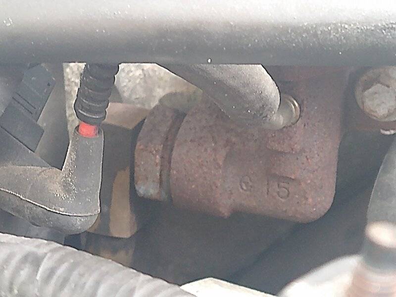

Yep understand now... so it was the Fuel Pressure Sensor that sits at the front of the pass side fuel rail. Apparently they broke it while doing a thermostat housing & accessory drive belt repair and they replaced the sensor with a generic aftermarket brand and only informed me about it when I went to pick up the car. Idling high now during driving needs more braking effort to stop and at idle in Park after a couple minutes has a weird stepdown to a lower (600ish) RPM that causes engine shake.

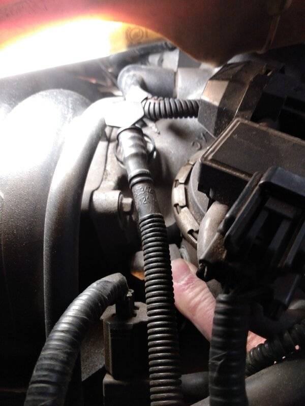

Thanks for the leads on the possible cause... EGR valve was not replaced but likely moved out of the way during the repair. I've had the EGR plastic tubes fail before but it has set a MIL when that happens (btw the plastic EGR tube assy is obsolete.) Is the ss gasket sandwiched between the two nuts connecting EGR valve to the stainless line? Will search if the washer fell onto some ledge. Thanks...
Not sure what washer you are talking about... but yes... the stainless gasket is sandwiched between the two flat surfaces of the tube and EGR valve.
The trick is to use a plunger type claw tool to hold the stainless gasket... make the bottom bolt first... then tip the gasket up in place... then make the top bolt.

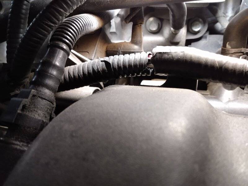

Is the ss gasket to left of the nut?
I just sprayed that junction (and the plastic tubes on EGR) with WD-40 and did not notice a decrease in idle.
View attachment 828577660Is the ss gasket to left of the nut?

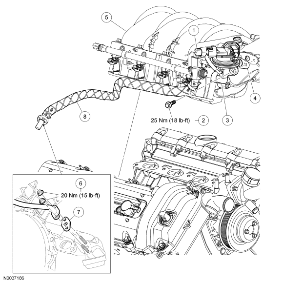

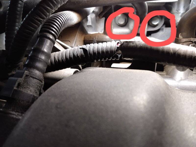

See the bolt in the upper right of the picture? There is another one left of that. Those are the two bolts that hold the EGR assembly to the throttle body adapter. The only stainless steel gasket that I know of there, goes between the EGR and the adapter and is held by those two bolts. There's no "gasket" at the flare nut, the flare seals there. Any leak there would be an exhaust leak and not effect engine operation.
As already indicated, your problem is the aftermarket pressure sensor, not a leak.
112B637Exhaust gas recirculation (EGR) system module connector
2W701232EGR bolts (2 required)
39Y456EGR system module
49D476EGR system module gasket (the SS gasket)
59424Intake manifold assembly
Nope... Just as Joe said.
There are 2 bolts under the actual EGR valve... that bolt the EGR to the passenger side of the intake elbow (going down).
Proceedure is to first remove the fuel pressure sensor first... then gently unthread the tube from the EGR valve... then remove the 2 lower bolts.
If there is still a stainless gasket in there... it will want to fall out. That is why you allow the gasket to drop on one side... then grab the gasket with the plunger claw tool.
Connector to the fuel pressure regulator... which is held in by 2 screws. That regulator has a nipple on it that usually gets busted when trying to unthread the EGR from the pipe.
