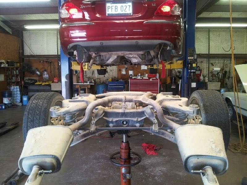

+1...I'm seriously thinking about scrapping my heap(s).....a buttload of extra parts as well...probably not, the gf won't come back now...time to drop a tank...or cut the backseat floor?
its really not that hard to drop the tank....now that i did it ones next time (Sat) will be a piece of cake....lift the car by the passenger side rear and put a car stand and take the jack out. Get underneath the drivers side and unscrew the gas tank strap with the jack under it ones you take off the strap the gas tank will drop on the exhaust. then unscrew the passenger side gas tank strap and the gas tank will drop just enough for you to work on the lines.
i wouldnt cut the floor bc the sender unit lines are right underneath and you can risk cutting something that you dont want to do.
