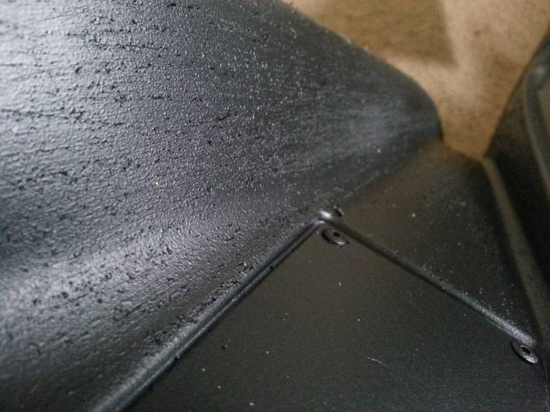

Thanks... The cover is Plastidipped.. I was "RELLY" pleased with the texture i was able to get... Did my Exby's grill last week and got it almost gloss with the same cans. I need to bend the lincoln plate a little better.

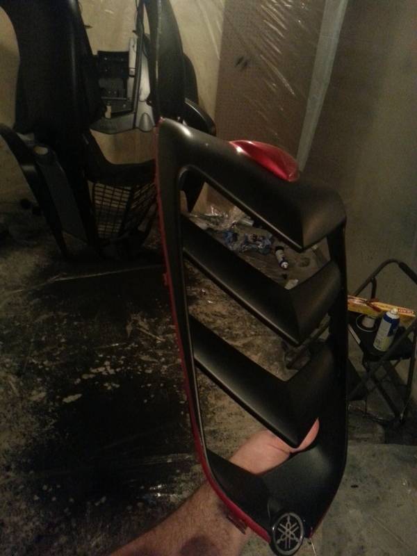

Finished an ATV this week:
We went basic on this due to time constants and schedules (hoping to go a little crazier after his ride this weekend...will use this black as a base afterwords)

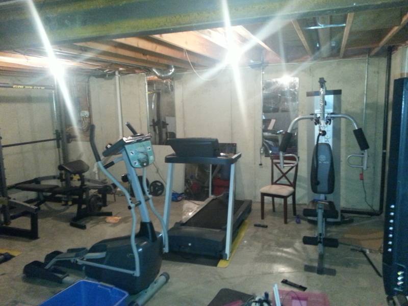

with it still dropping below freezing at night here (and some days), I didn't want to leave these pieces in the garage over night (or our cars out either)... So I did what everyone does after their New Years resolutions: Moved our exercise equip. out of the way :p

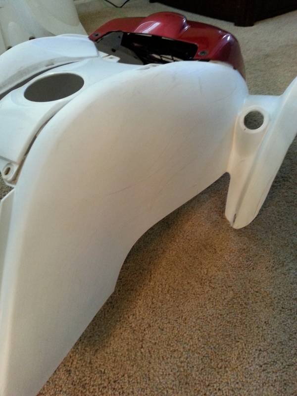

Previous owner had cut the fenders, sanded the plastics and attempted a flame job... also had some minor rash and grille chips:
If i had to guess, Id say it was 40 grit that was used

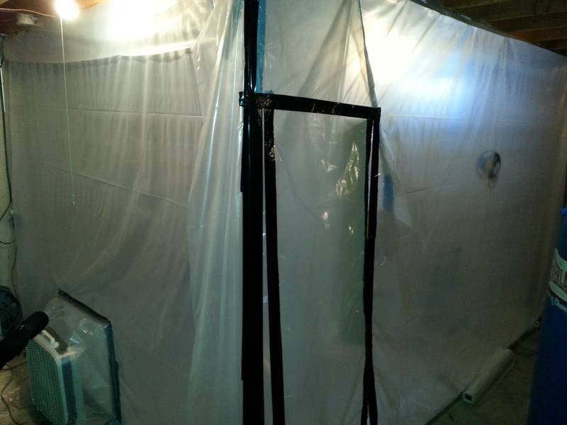

Booth worked perfectly with great positive pressure and plenty of room (~10'x15') ...door worked but needs some improvement:
Here's were i made my mistake:
After taking with the owner about how bad the sanding really was (picked up pieces at night), we choose to SEE if the dip would cover/hide the grooves....
It didn't go so well
obviously not going to work...so had to peel:
smooth areas were fine:
sanded areas a little tougher, mix between dip being to thin, and grabbing the groves, it took awhile (luckly the wifey wasn't doing anything :D).
It got ugly:
Got the orbital out and started over:
Also gave me a chance to fix some of the road rash I missed:
Black done!
and threw some stripes on for now:
His frame and bars are painted this red... so we left a bit on it (also covered the paint chips):
Installing tomorrow, I'll get some complete pics then!

Booth was easier then I thought, 4ml 12x100' roll of plastic, three rolls of duct tape, a few furnace filters and a staple gun...

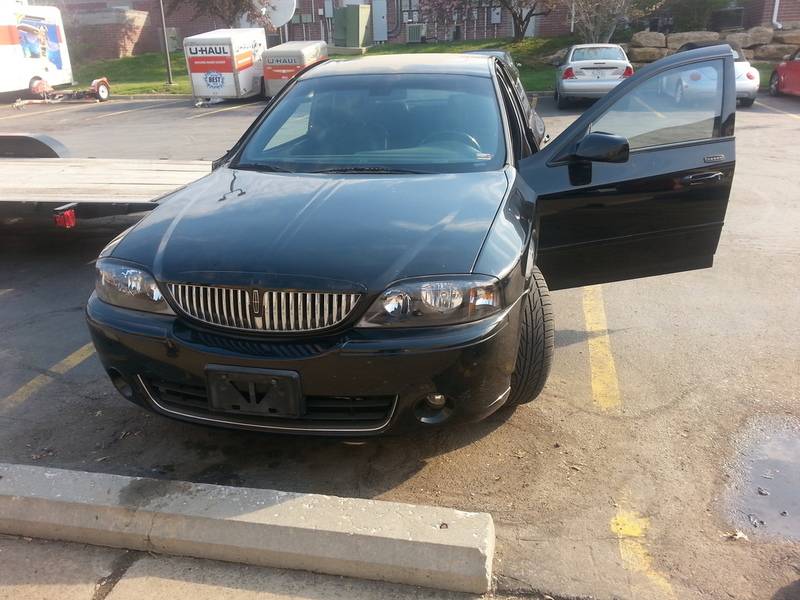

Starting with an awesome find here in KC Hite and I picked up...06 black on black with 110K on it.
Unfortunately (or fortunately for us) it was hit on the side:
We started with a body shop to see if it was fixable.. It was. So Hite started his JEDI tear down checking all the systems to make sure it was worth fixing...It wasn't.

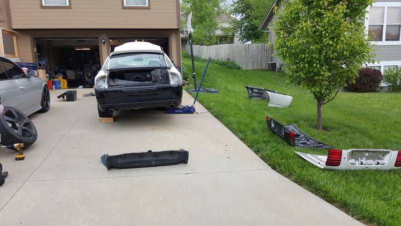

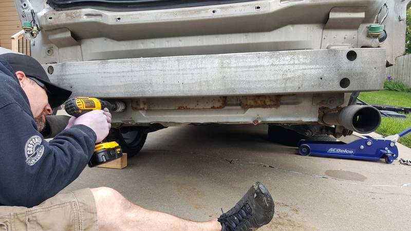

hole for the rear sensor harness

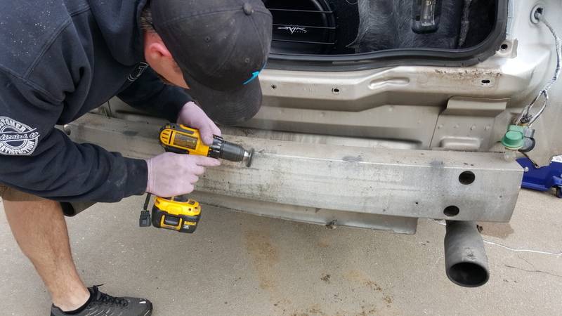

Hites obsession with perfection ... we had to adhere the absorber to the metal (not just stick it on)
...also initialed his work (ass)

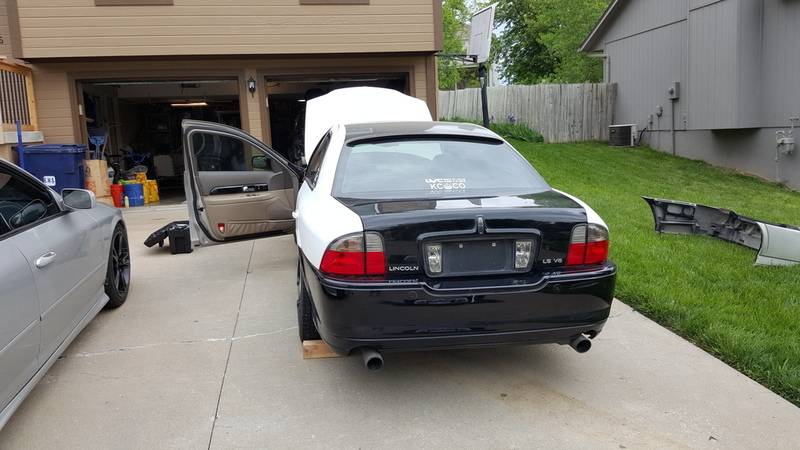

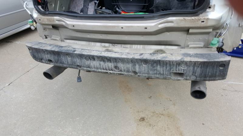

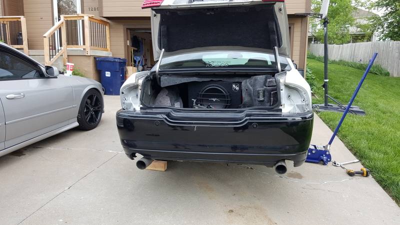

New bumper (had to rework exhaust)

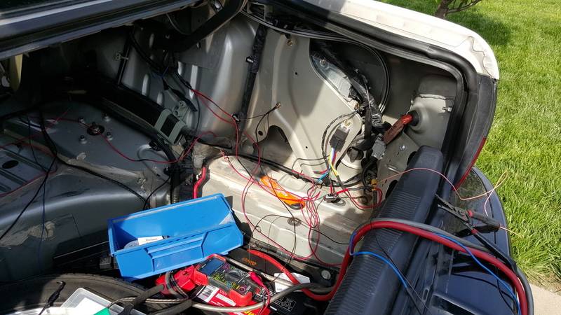

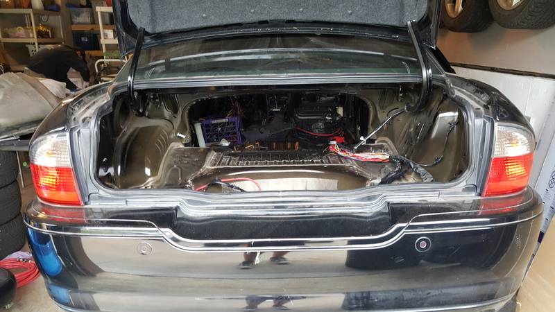

joining both wire harnesses together to make both ends plug and play...
Yes those seats will be part of Hites thread
Relocating of the gen 1 fuse box harness
Wiring of the rear backing assist module ...thing (this will probably get its own right up, but basically just wired back the sensors, relay for power and reverse signal, and a wheel speed signal)

Hood swap and washer cowl swap
Side skirt swap
Horn swap (lol)
AND EVERY ENGINE FASTENER (they all match now!!!)

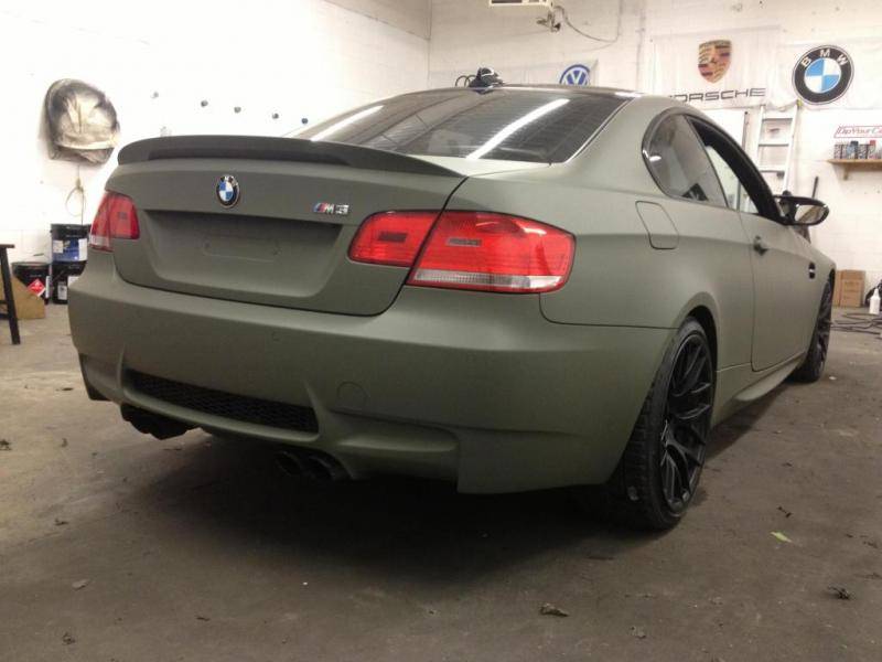

Camo dip!
Way cool work there guys ... one of these days, should I come trucking through MO, I'll have to ring the door bell, I'll bring the JEDI juice!
+1
G, I'll paypal you a contribution if you do a full Camo dip!

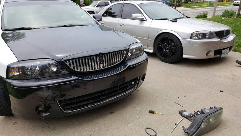

BTW: GEN II headlamps into GEN I wiring, any special needs, wiring? direct fit? hi-beam is hi-beam still? Thought Rollin had to rewire something.
I cant recall the wiring colors but passenger side was same colors gen1 to gen2, drivers side had the high and low beam wires reversed if i remember correctly.
