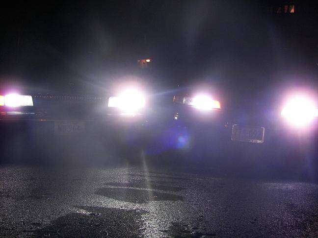

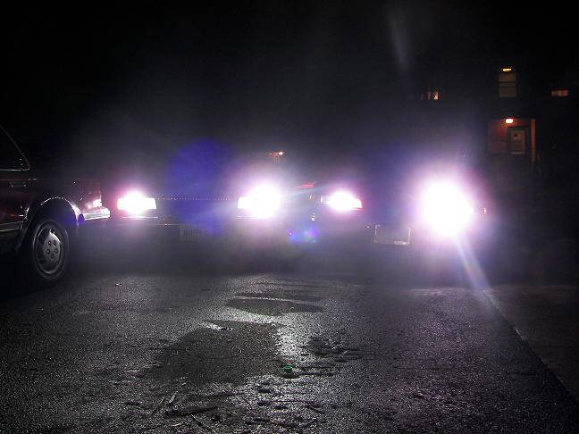

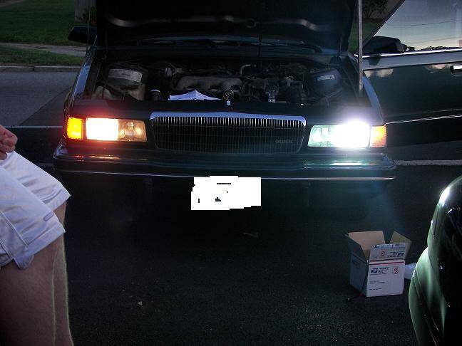

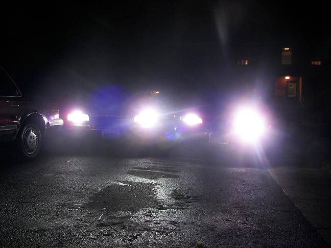

My moms 95 buick century, looks sweet with her color paint.
6000k from Japanimportshop on ebay.
Just did this on my 94 and it is wonderful. I didnt open up the housings they were already nice. But I did put those lights in (6k), and they are beautiful.
