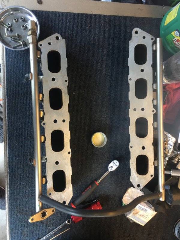

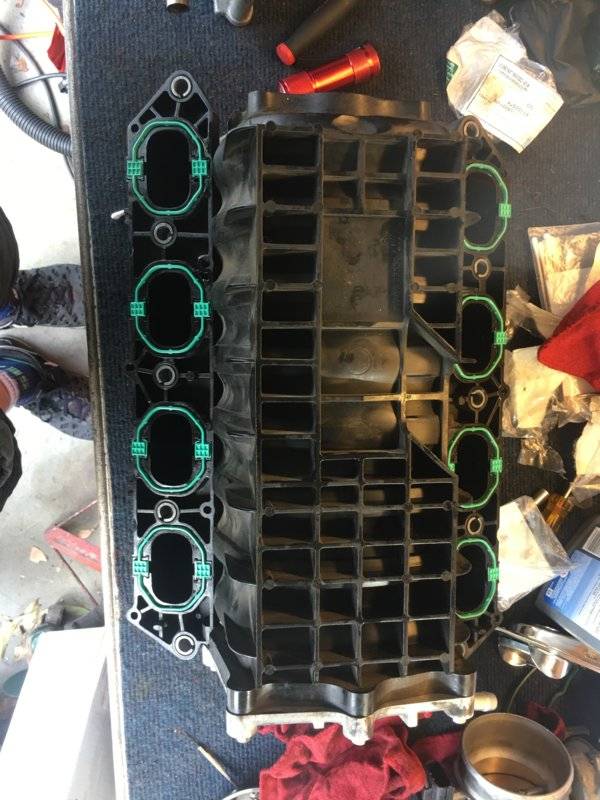

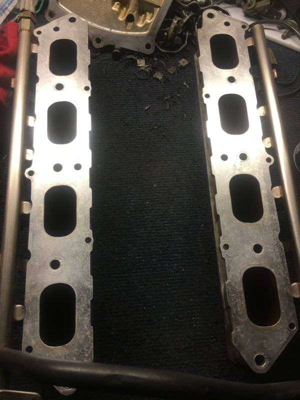

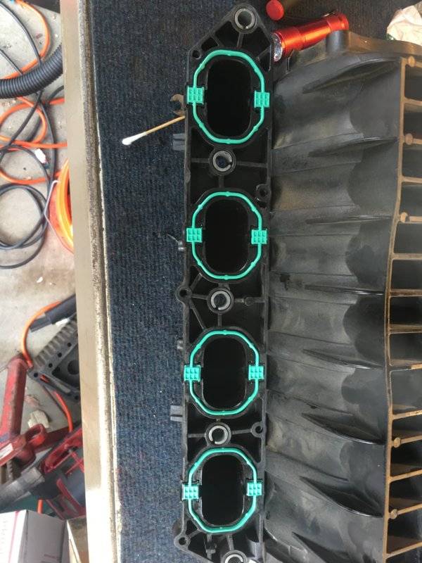

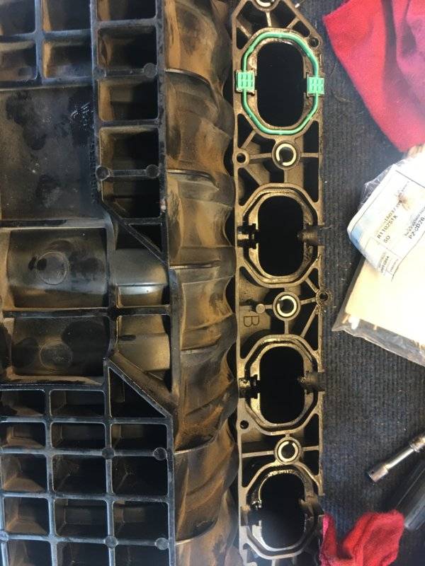

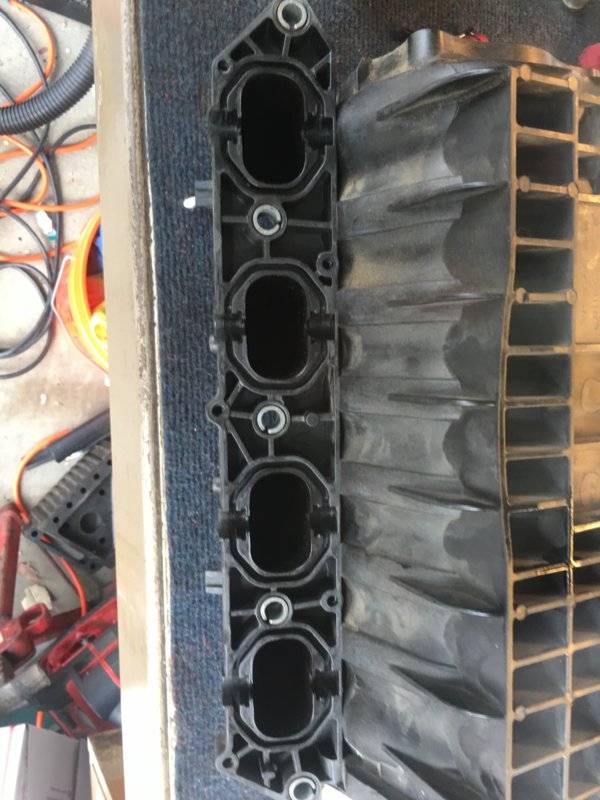

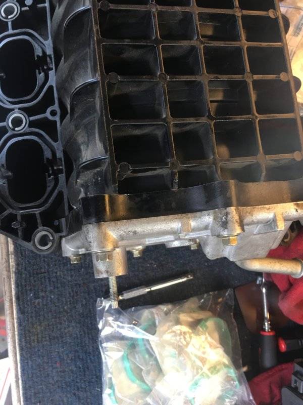

I got everything cleaned up all nice and cleaned up like. With no torque numbers, I went conservative with 75 in/lbs for the torx screws on the new gaskets.

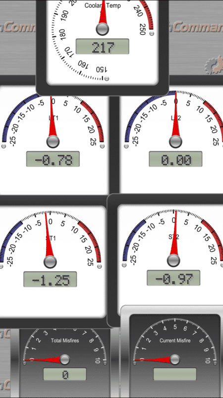

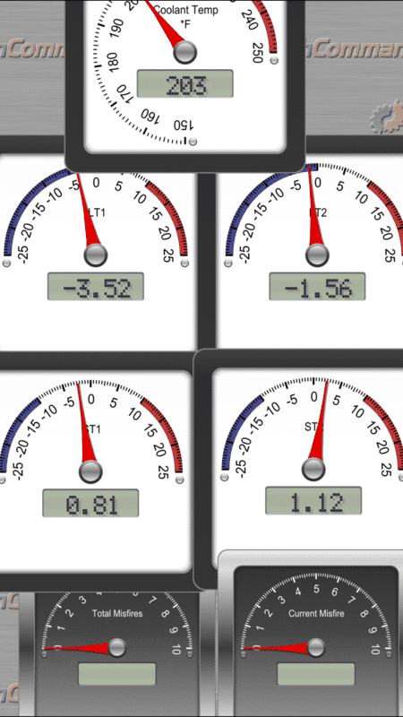

I put everything back together (nearly forgot to tighten the EGR tube), refilled coolant , started it up and ran horrible (during my coolant system bleed process). After I finally found my OBD reader, my short term fuel trims were +25. Then my CEL comes on, I read the codes and cylinders 2 and 6 injectors aren’t connected. Of course the clips have deteriorated and they don’t click on and came undone. As soon as I reconnected them and restart the car, she purrs like a kitten!!!!
Here’s a picture of the fuel trims and some assembly pics.
The real test will be tomorrow morning on first cold start.

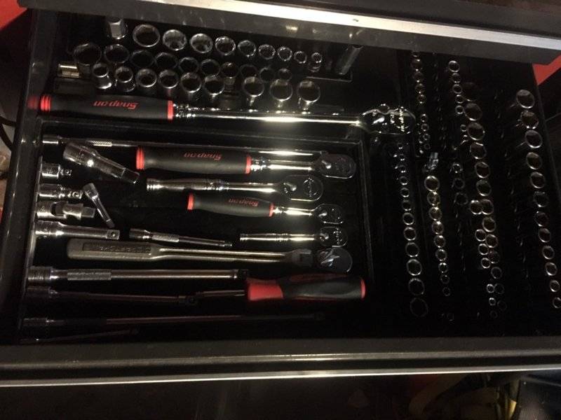

Off-topic: Is that a snap-on wrench I see there?!? Someone's rich ... or professional. :D

Yes, Snap on!...Rich, NO!...Professional, well not in the auto or mechanic world. LOL I was tired of using cheap tools that wouldn't work quite right and break or fall apart. I have only bought 1 socket off a truck at retail. Most, if not all, of my purchases have been off ebay after great hand wringing on getting as good a price as I could. Also, I got a significant amount of tools from my dad. And, finally, Snap On has spectacular customer service and look cool in the drawer! (see picture).
