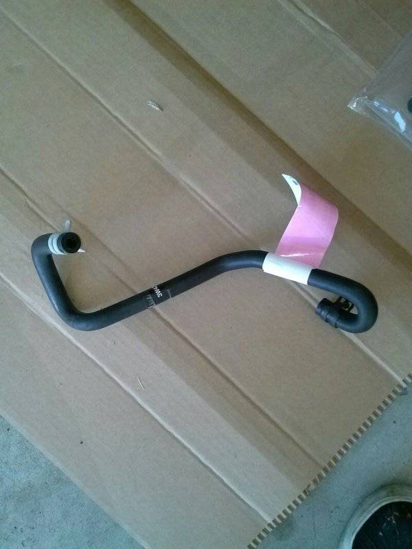

View attachment 828472840 this hose is also part of the cooling system I haven't seen many suggestions to replace this hose why is that
actually it is, every body that knows what is going on and how to truly fix i, knows that you need to replace EVERY plastic cooling system part, that being one of them.
View attachment 828472841 should I replace this hose to
ask you self this one, does it contain plastic? and does coolant run through it?
any parts that you don't replace, could break or leak at any time after your first sign of a problem. and there have been a lot of people who refuse to listen and only replace the one bad part, then next month they are replacing another part, then two weeks later they are wondering why they are starting to overheat again... #ViciousCircle

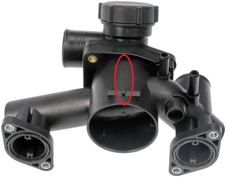

welp - here we go. overheated this afternoon. temp gauge spiked really quickly. pulled off, shut her down, and noticed what i think is a hairline crack in the "8548A" / "4Z-8548-AD" (Main Plastic Body), as indicated by the red circle.
coolant had spewed a bit and was at that time barely bubbling out. tank was a little low so i filled that up and let it sit. after an hour or so, turned it back on and let it idle - seemed fine, no coolant coming out of crack. so i drove it a block down the road and back, still nothing. anyway, i'm sure i need to replace that item (along with everything else), question is can i simply use this item and cover 2 separate pieces?
http://www.rockauto.com/catalog/moreinfo.php?pk=5790486&cc=1426137&jnid=434&jpid=2
Someone else on the forum is trying it right now, but it hasn't been long enough to say if it was wise or not. Dorman makes a really terrible degas bottle of the LS. It's possible that this part will be good, but it seems to me that the odds of that are low.
i know, i know...dorman. just seems convenient that this is already put together.
The amount of time and effort required to put that together is nothing compared to the effort to install those and the rest of the plastic parts, especially the one that those connect to.
fair point joe. i drove the car a few miles yesterday to a safe location with the A/C off and it did fine. just have to decide if i want to bite the bullet and pay someone to do this for me, or accumulate the parts and do it myself. ugh.
