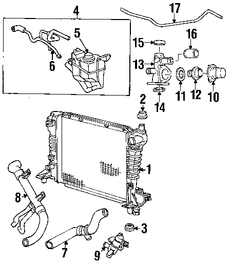

Looks like if you order from Tasca's website you have to order the hoses as separately. Is it recommended that the hoses are replaced when the bottle is replaced?
http://www.tascaparts.com/parts/2000/LINCOLN/LS/?siteid=213668&vehicleid=1363632&diagram=KD00130
Do LVC members still receive a discount from Max?
Read again the hoses are included.
Thanks, I have trouble reading sometimes and I missed where it said the hoses were included with the reservoir. :rolleyes: Even though the diagram shows them as a unit, number 4, the reservoir doesn't say they come with the hoses(I am referring to Tasca's website). Emphasis added below.
If you add up the reservoir and hoses the total comes out to 134.87 while the eBay listing is for 134.79.
[ 3 ] COOLING SYSTEM / COOLING / RADIATOR & COMPONENTS / Radiator lower insulator
radiator lower insulator 3.9 LITER Left
MSRP Core ? Online Price
$12.13 $0.00 $8.01
radiator lower insulator 3.9 LITER Right
$12.13 $0.00 $8.01
[ 4 ] COOLING SYSTEM / COOLING / RADIATOR & COMPONENTS / Reservoir
reservoir 3.9 LITER
$179.95 $0.00 $118.77

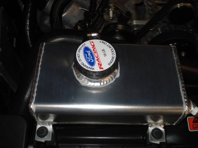

Now this is what I'm talking about! There may not be a direct replacement, but I bet I can figure out something that will work... if you don't like it, tough! :D
Ford Racing M-8080-A
Certainly, the degas bottle could be more rigid. I think that the point before is that the plastic bottle experiences changes in pressure and it does flex when that happens, not that it has to flex.
The key things that you need for a fabricated degas bottle to work are:
1. It needs to have the same or greater volume.
2. It needs to have the internal tube that goes to nearly the bottom of the bottle that is connected to the engine coolant air port.
3. It needs to have a 15/16 PSI pressure relief/regulating cap that vents when the pressure goes over 15 or 16 PSI, and that allows air back in when a vacuum starts to form.
4. It needs to be the high point of the cooling system (or at least as high as the present degas bottle).
It may be possible to rig something with the gen II jaguar S-type reservoir, but be aware that its plumbing is a lot different than the LS.
