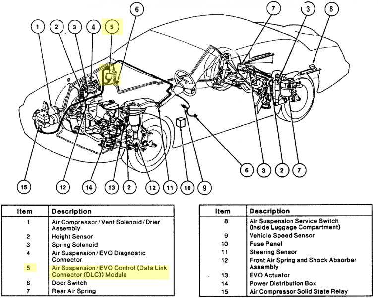

I am cleaning up the DA now so I can get pics for Craigslist and also pics for here in case it doesn't sell and I end up parting it. I'm thinking a week or two max on Craigslist. I will respond to inquiries about parts after I see if it sells whole. I'll try to get the compressor off it this weekend. And the air ride computer. Where is the air ride computer?

Pull the compressor, forget the rest, maybe the ride height sensors if still there.
The air ride module is in the passenger kick panel it also controls your power steering speed I wouldn't mess with it.
