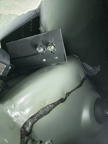

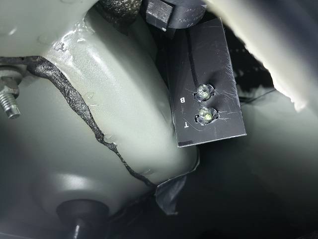

Instead of installing resistors that get really hot, I simply used t5 instrument cluster bulbs for each circuit, and since they don't get burning hot I tucked them in behind the trunk liner. They only pull 180ma's each, which is enough to fool the lamp out warning. I also didn't spend a lot of $ for LED's, I used Sylvania Zevo bulbs that were only $14/pair w/lifetime warranty. They are super bright and have been installed for over 18 years. My youtube channel https://www.youtube.com/channel/UC-Tv0kuDyQhbH-DrqF71zYQ/videos has a video of my LS showing how bright they are. The Sylvania Zevo's came in 2 different styles, reverse facing LED's (that require a reflective bowl behind the bulb), and forward facing LED's. I used the reverse facing LED bulb for tail/brake and the forward facing LED bulb for the reverse lights.

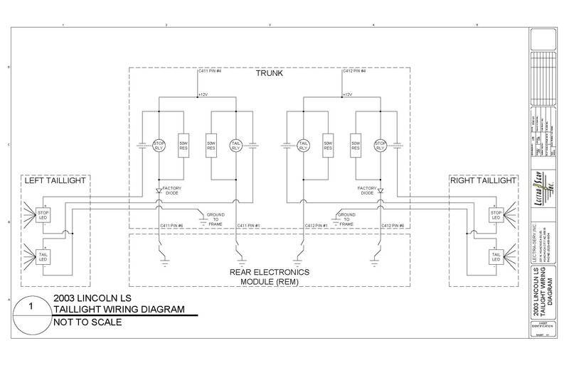

Hey guys, I've done a full LED conversion on my 2003, stop lights, running lights, turn signals, everything. I have no errors. You'll need to wire in some relays to change polarity of the sockets in the taillights, as the factory uses a common positive, switched independent grounds for the stop/running lights. Attached is a wiring diagram I made of how I connected them.
Cheers.

Also you may want to look at my post above, if you haven't changed the polarity of the bulbs by adding relays, you probably won't have working running lights (or rather the stop lamps will be on constantly and people won't know if you step on the brakes). You can get the bulb out messages to go away with the resistor wired correctly, but it won't fix the running/brake light issue.
