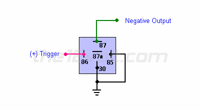

Okay so the 12v switched would go to 86, the fan ground would go to 87, and the relay ground would go to both 30 and 85? And 87a stays open? I suck at this stuff so I have to cover my bases. Would any of the relays in the engine fuse box work for this? I could do without heated wiper seats for a day or two if that would work. (same numbers on it, but IDK if it functions the same way?)
You are correct about the wiring of the relay.
There may be a 12V switched wire in the fuse box under the hood but IDK which one it is.
